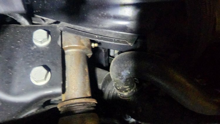

Installed the front receiver hitch and receiver hitch winch. No modifications to the rabbit comb required.
Stole the gooseneck winch for the time being..
While I was underneath, I installed the moog idler arm hose kit. Remove grease zerk, install the 90° fitting and hose, connect to the swaybar bolt...

First I've seen/heard of the Moog idler arm hose kit.  If I'm seeing it right does this just act as a remote grease point that's easier to get to?  Interesting.  Your receiver mount turned out perfect.  That sure will come in handy.
That is correct. Don't have to remove the 4 15mm bolts to drop the skid plate to service.
That’s fantastic. Is there a part number you used? Thanks

The receiver bolts on using the rear bolts of the tow hooks and existing holes on the bottom of the frame. No modification needed.
I went out the trashcan and took a picture, before I realized I bought them from amazon.
Moog K6714
