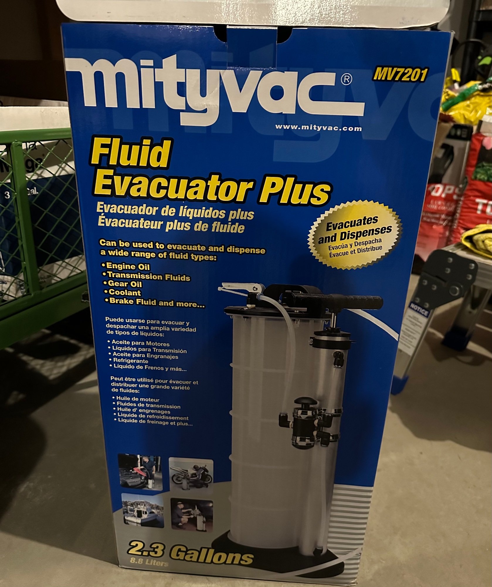

Well gat dabnit why did they decide to take it away? My 22 has a fat spot on the bottom the right size for one to be tapped in but they never did. What a joke. Well I received this on my doorstep today so the diff fluid will be my first of many uses for this thing.
I could see this doing a great job of swapping out trans fluid on this truck in the future too once a dipstick is installed.

So my differential was indeed low from factory specs of 3.17qts.
I removed 2.5qts with the super sucker 1,000.
so it wasn’t horrendously low but still, that is very poor quality control at the factory. I can’t imagine they don’t have a machine that is computer controlled to squirt exactly 3.17qts in, so why the discrepancy between different trucks on this very elementary thing??
You may ask how do I know I got it all out. Well this process took longer than I anticipated. And also I let the truck sit for an additional 30 min or so and brought the super sucker 2000 back over and nothing else came out. So I ran a small flexible magnet down into the diff because I’m super ****** and had the time to see if any magnetic material appeared on the magnet. None did and it was also dry.
The fill plug was also clean without any magnetic fuzz.
it makes sense considering when I checked the factory fill, it was about .9” from the top.
I put in the 3.17qts and it is now roughly 1/4” from the top.
So how did the super sucker 3000 do? Well the machine itself is a beast. It sucks like crazy. (Hey now) and seems well built. The problems are as follows:
The hoses that come with it are hard cheap plastic and they prefer to stay coiled up. Even when room temperature, they don’t lay out. So they don’t like to stay where you put them.
The main hose is like 5/16 so it’s decent. The others are very small, like 1/4” which you need to reach the diff so even with the fluid warm from a drive it took forever due to that small hose.
For an oil change or anything top side that isn’t doing a diff, it wouldn’t matter.
I will get some more large hose that is softer.
Edited by Pryme

It was 116.00 on Amazon sold and shipped directly from mityvac.
I will for sure use this for small engine oil changes especially my super annoying push mower that Ariens designed so the crankcase drain plug is literally on the deck. So there is zero you can do but have the oil drain onto the deck and hope to tip it towards a container. It’s a joke. No room for a tube either.
so I will be using super sucker on it.
But this thing would be great to pull transmission fluid out of these trucks because you would know exactly how much you pulled and simply add that amount back in.
