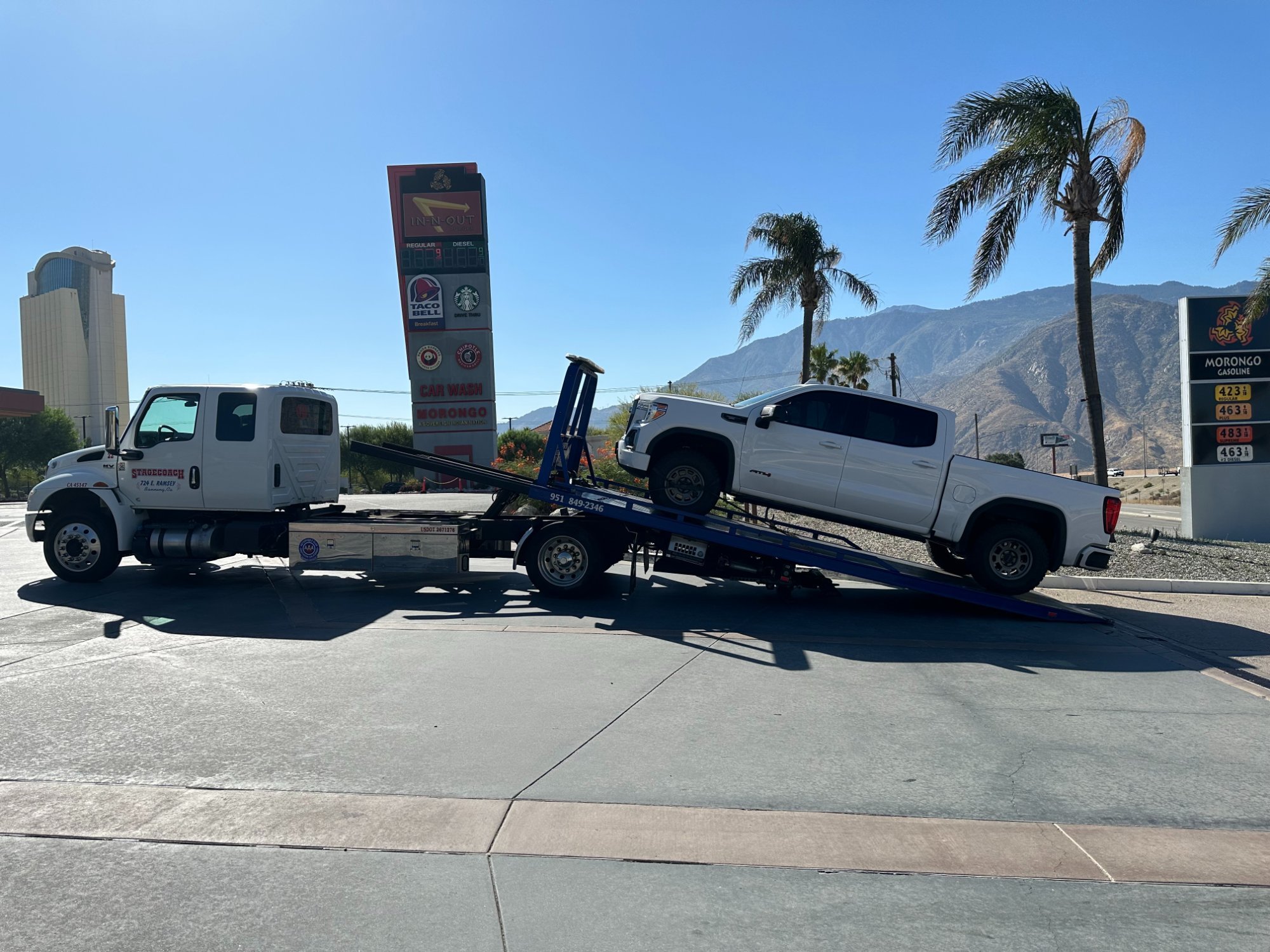

Update! I think my transmission failed today, at 104,766 miles. Just out of warranty. On my way to work, doing 75 down the freeway, the truck lost acceleration and felt like it was in neutral. I coasted off the freeway, and while coasting I heard a bit of grinding.  Once I stopped, the truck will not go into gear. It feels like it's in neutral. I was 60 miles away from home so I had it towed to the nearest dealership, where it is being diagnosed.
