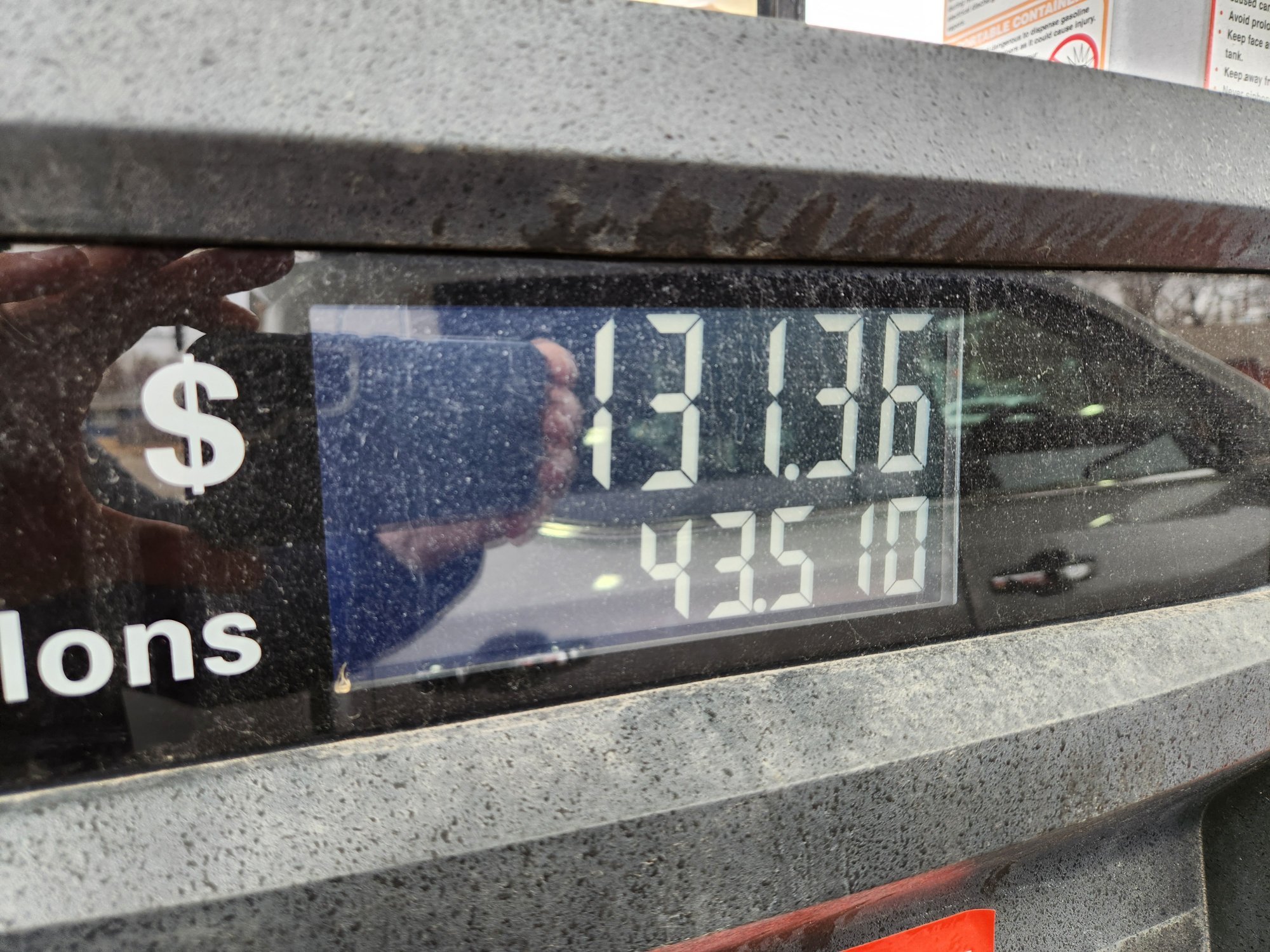

I filled the tank today. I was running errands when I got the "Low Fuel" warning. I stopped and fueled it up to the brim. Some quick math:
  • Remaining Range Indicated = 50 (multiply by 2 to get a real ballpark of range with the 50-gallon tank)
  • Recent Avg MPG = 16.8
  • Calculated fuel in tank = 50(2)/16.8 = 5.95 gallons
  • Tank took 43.5 gallons per the pump
  • 5.95+ 43.5 = 49.45 gallons total
  • ~.5 gallon is not accounted for in the range calculation.
I'm surprised that there is only .5 gallon not accounted for in the calculations - the gauge is extremely accurate.
Photo from pump; I went to one of the cheaper places in town at $3.01/gallon

That's not 93 octane is it?  93 octane in west Florida is about $1 more.

Different states have widely varied retail prices for gas. Cost of supply, transport, and state tax are some of the variables. The post isn't about the price of gas - it's about the freedom of range the larger tank has.
