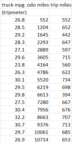

I have a few fills at over 700 miles, and lots at over 600 miles - '23 3.0L crewcab/4wd/6.5ft
It range is a serious issue, the 3.0L is your friend.
Fwiw, I got about 20-21 doing same job with a '16 5.3 crew/4wd/6.5ft
