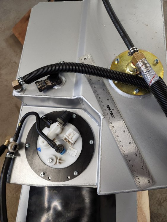

  1. I didn’t have a ¼ BSP Tap for the pressure control valve plug. BSP isn’t something you get at the hardware store in the US. Order one in advance or I used a ¼” NPT plug and tap and it seems to work fine.
  2. Swapping the float arm was painless, except it would be easy to break the plastic mount if you aren’t careful. Be ready to replace the sender if you break it. I did have a lot of trouble peening the end to hold the float/washer on the end - It isn’t soft wire and I didn’t have the tools to do it. A spot of JB weld saved the day.

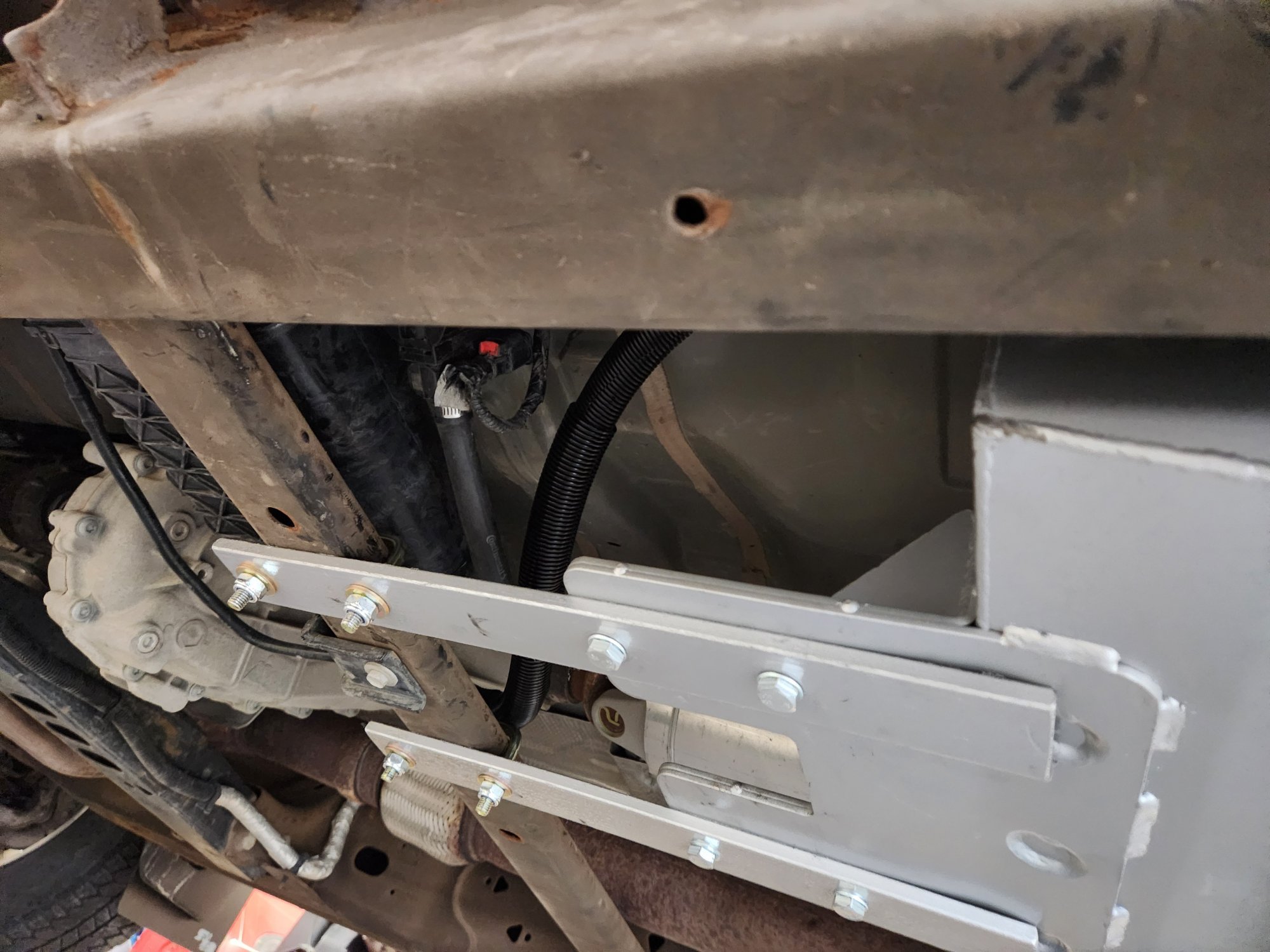

  • I used 2 18”x2"x3/8” steel plates and M10 grade 8 bolts to make the front bracket. I think it’s plenty sturdy.

On the right is the 5/8" hose that caused a minor issue later because it was too short, also note the galvanized 1/4' NPT plug in the sender and the barb on the left of this photo (this is the problematic right barb you can probably install later):
No-weld bracket:

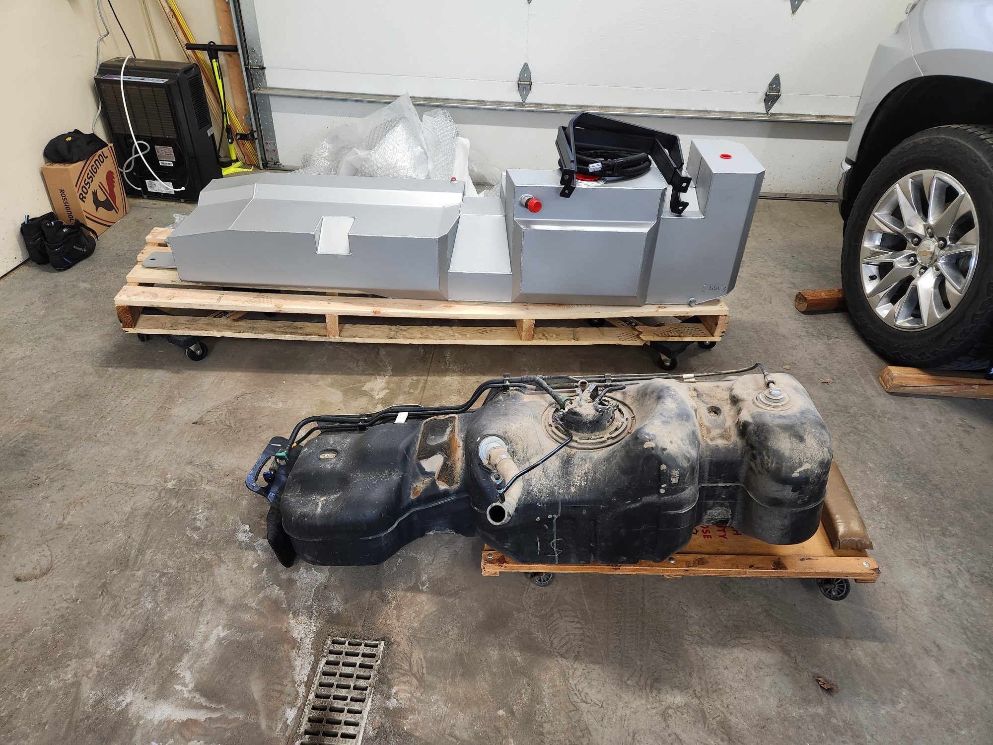

Size comparison:
The website keeps flipping this upside down, I assure you I did this install in the traditional orientation :
