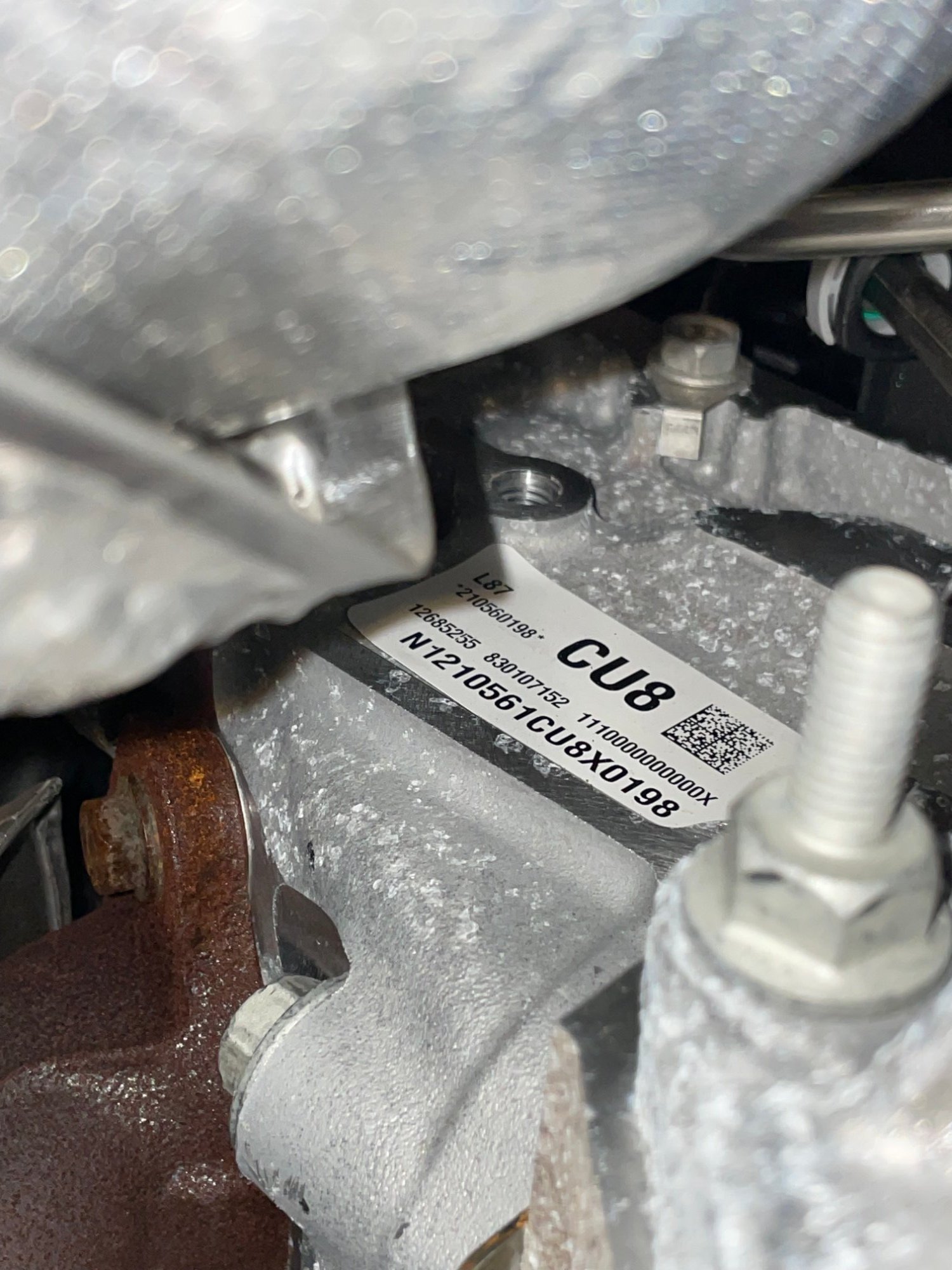

Could you decode this 2021 6.2 build date of truck 03/21. I know my build date fall in the range but does the motor? N1210561CU8X0198
Edited by WeGone
Recalls are VIN specific.  You will have to run your VIN and see which of the 3 recalls will apply to it.  So it could be 000, 001 or 002 recall.
Julian is 21056 so 56th day 2021.
Edited by newdude
