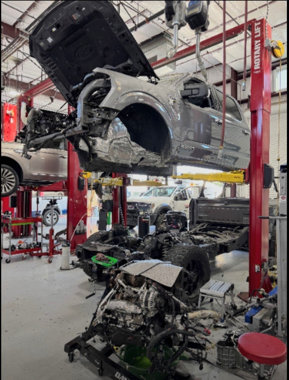

Here's a real pic of what is involved with swapping out a motor that's happening right now on a new Ford. This pic was taken in a dealership service bay a few days ago. I apologize for the quality. If it's hard to make out, the entire body of the truck is lifted up off the chassis, and you can see the engine on the ground in the foreground. Never mind replacing the motor, or "only" dismantling it to just inspect the crankshaft or connecting rod, or whatever inside the bottom of the motor. Either way, do you think this truck will ever be the same, or do you think it's possible that this job will end up introducing new rattles, squeaks and vibrations even with a new, better motor installed, because not every single thing was put back correctly? Something like that would be yet another headache GM might face, even with complete swaps of all the motors, which is another reason why buybacks may be being discussed internally.
