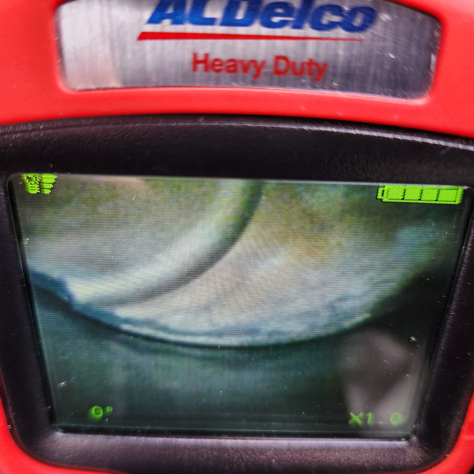

Sorry for not being the best picture, but this is a bore scope view of the #1 cylinder in my 145,000 mile 5.3L 2011 Yukon.  This vehicle has been running on E85 about 80% of the time, never been apart.

Outstanding!! Thanks for the snap.
