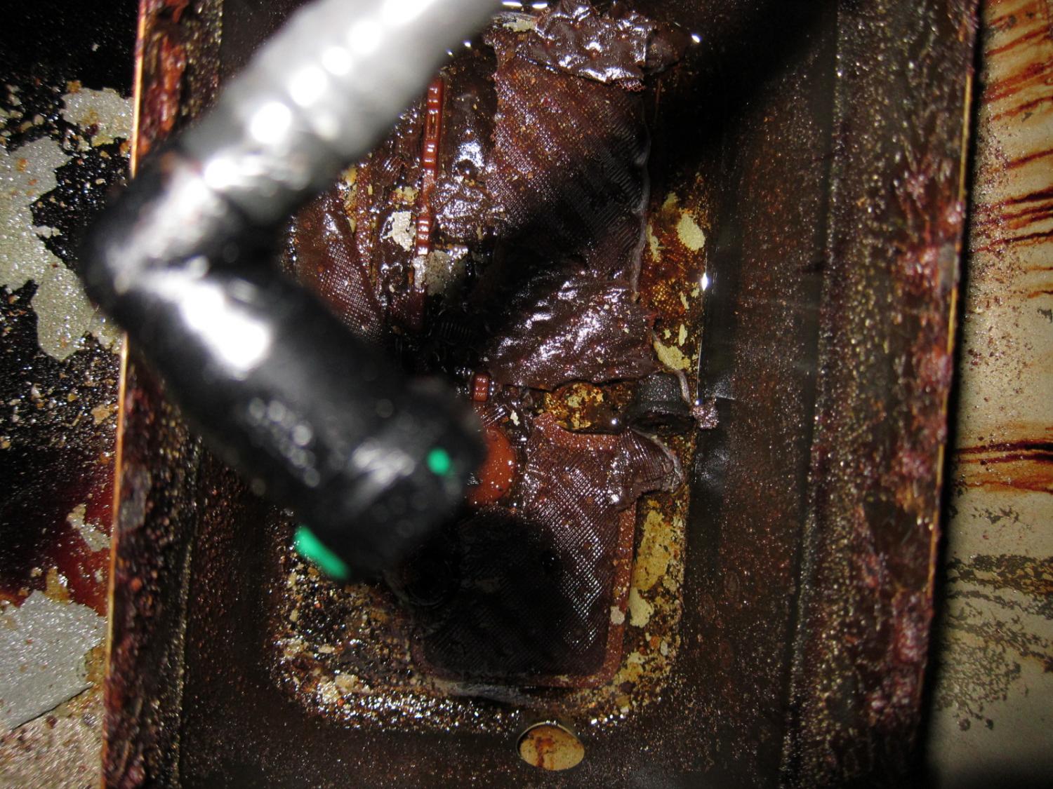

Well so much for an easy fuel pump swap in that '05 Mustang ... :banghead:
Ordered a fuel pump and it got here today. Yanked the seat up, and got the old pump out. Figured this would be an easy half-hour job. NOPE! Not in the 21st century ...
So that side of the tank was full to the brim - gas peeing everywhere once I removed the pump. Smelled like varnish - totally stale, so I siphoned the rest out (was going to anyway to make sure tank was clean). Check out the tank after it's empty, and it's a MESS of rust. Screen stuck to the bottom of the tank. It's so bad I don't think I can clean it, so I start looking for another tank. Had no idea there was a SECOND fuel pump and sender on the right side! WTF - can't anyone build anything normal today?? So now this went from a $300 pump job for the neighbor, to probably close to a grand by the time I source a tank and secondary pump. Guess she's gonna be here a while ...

Stuck the camera in the tank for this shot, straight down:
