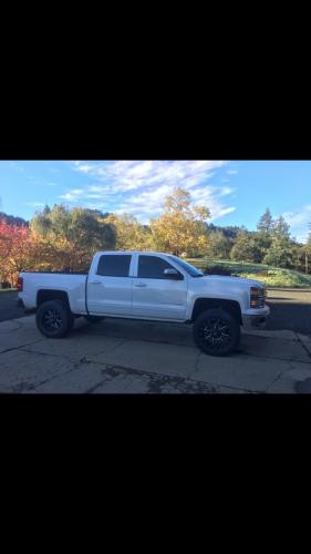

I mentioned in my previous post I went with the BDS full leaf spring replacement (ride glide leaf packs), so no blocks other than the stock block and you can see in the pic the rear is higher than the front. They are made to keep the same towing capacity as stock and give the rear about a 1" higher rake.
The add-a-leaf from BDS I believe gives the same stance if using the big block from the kit.
The block alone, seems like the back ends up even with front, from what I can tell. Some trucks looks even a little lower in the rear.
Finally a good sunny day where I can take some pics of my truck finished lol. BDS 6inch with fox shocks in the rear, running 35x12.5x20 Toyo Open Country MT's on Fuel Maverick Machined face 20x9+1 7be2cc552d15a289c4ca4235e7294a7c.jpg65316758215cabc180f157a7d9ac651a.jpg7be2cc552d15a289c4ca4235e7294a7c.jpg99b4fb7bd971609bca253ca10adb39c5.jpg6cebfe50e5bb309ddc8e394f666521ab.jpg6194975c7ff0187b3135931175d99dc0.jpg
Truck looks awesome. How is the gas mileage?
The gas milage I'm not 100% sure about yet since I haven't recalibrated but...I can tell a significant difference. The DIC is saying around 13.5 average, for me thats a 50/50 split between city and country on my drive to work and back. I'm guessing once I recalibrate that like most on here i'll be seeing 15ish somewhere or around there. I took a 300 mile trip last week after it was finished and was doing better at highway speed just cruising, the DIC got back up to 16.5-17. Ill post later when I get the tuner and fix everything lol. Over all its not bad though. I went from 1 tank a week to 1 and a half.
