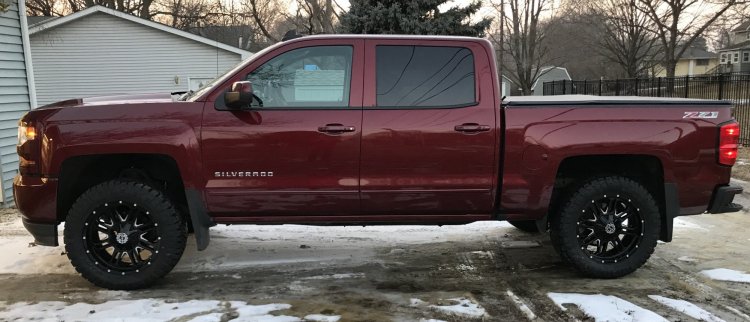

Here is my 2016 Z71. Went with Nitto Ridge Grappler 295/55r20’s on Scorpion 20x9’s with -12 offset. Also went with RC 2.5” lift and RC UCA’s. Had to trim the slightest bit off of the inner mud flap in the front, no rubbing now98C18A1C-C8D2-4A46-B209-63B07F64FF17.thumb.jpeg.4b5083ec38264c5776be131b3108d444.jpeg3C5646EE-3F8D-4CD6-B82D-092D331508F5.thumb.jpeg.cf157bb0cae542c5c7502681ef789f1f.jpeg.
