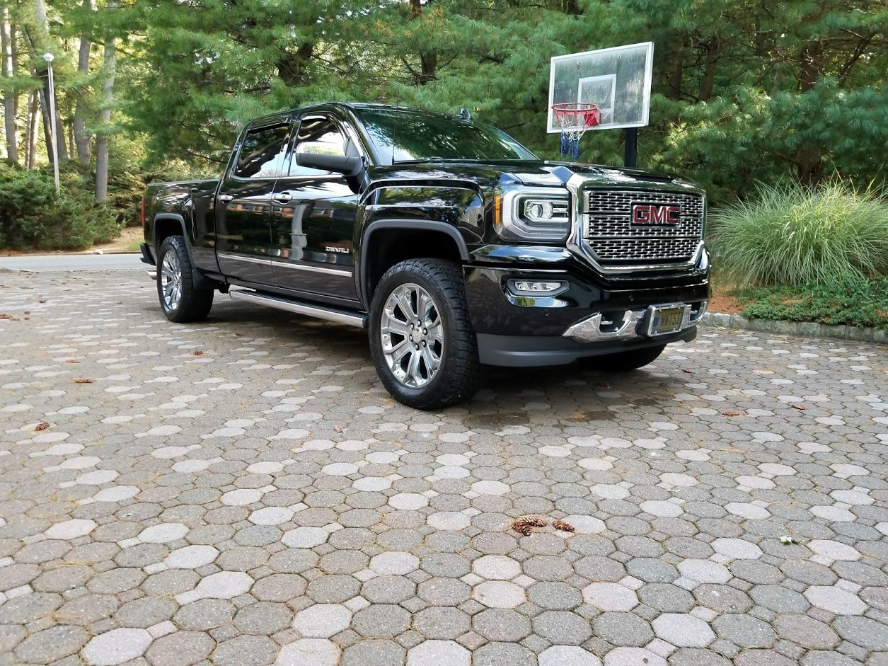

Before he installed the 1/2” spacer he would rub at about 90% turn (give or take) after the install he rubs after like 98% turning (again give or take) im just not sure if its from the uca or the sway bar. wen i see my young brother again ill check where the rubbing is coming from
Hope this helped
Thanks, I appreciate it man. I’m rubbing at full lock but I’m not confident running spacers or trimming studs
On ‎2‎/‎20‎/‎2018 at 11:43 PM, GMCaholic said:
My young brothers set up
3” level up front nothing in the rear
22” factory chevy wheels
35x12.50r22 toyo mt
1/2” wheel spacers in the front
Minor trimming on front
Looks pretty clean if you ask me
Nice truck
in b4 everyone says "it's impossible" "massive trimming"

It must the width of your tire as mine does not rub the control arms or anything other than the inside plastic trim on full lock. I just walked outside an looked again to make sure but ive crawled all under mine after I installed lift and tires. I read a 33X12.5X22 rubbed like crazy but a 285/55/22r is 34.3x11.2. I will take pictures this evening an post. I have lightly taken offroad and no more rub than on street

I have nitto Ridge Grapplers is only thing different but I swear I only rub the inside lip of plastic trim as ive actually gotten out and checked when I was rubbing. I went out at work and took these and turned wheel completely to left lock. The last one shows the little rub I do have circled in red. I will fix this with a knive and ziptie sooner or later
