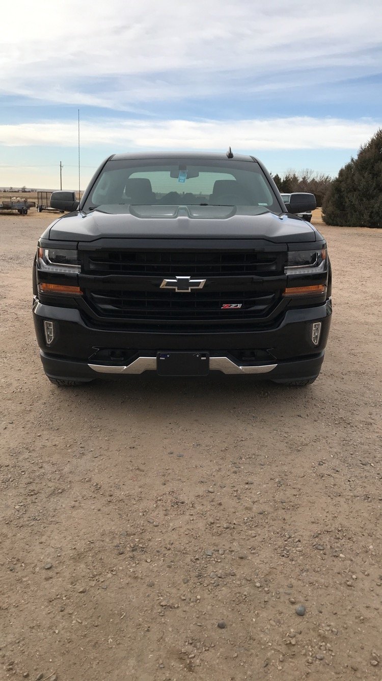

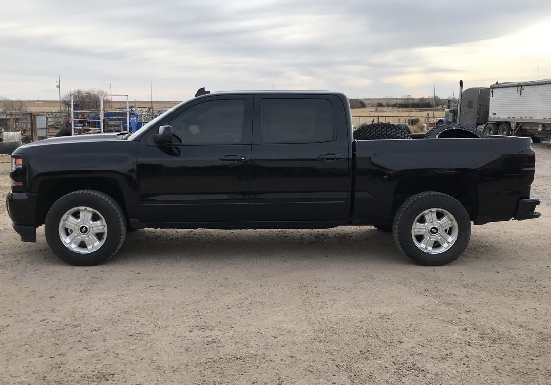

Installed a 3" Motofab level on my 2016 Silverado Z71 last weekend. Rear is stock. Wheels are 20x12 -44 offset and tires are 33x12.5. Took some plastic and metal trimming, no rub at full turn. Before and after pics below. Smoking my turn signals and corner markers this weekend.. will probably vinyl wrap the chrome bumper mustache too.
That is a great looking truck! How are you liking the Atturo's so far?
Loving them so far. Only have about 400 miles on them. They growl a bit at low speeds and hum over 50+, but I actually like hearing them. Nothing overwhelming. Very smooth for a mud tire. My little brother has them on his 2009 and they're wearing very nice.
