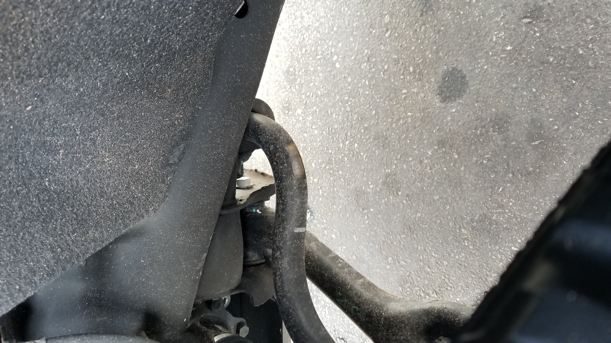

I would be afraid to go any serious off road with this set up. I have exactly what you do, 285/55r22's and there is rubbing on the control arms. I can feel it hit as I turn. especially in reverse.

Heres a quick pick of evidence of rubbing

Yeah it's not the height of the tire, it's the width that cause a rub on the sway bar, control arm or fender. The height will usually only cause rub on the fender.
