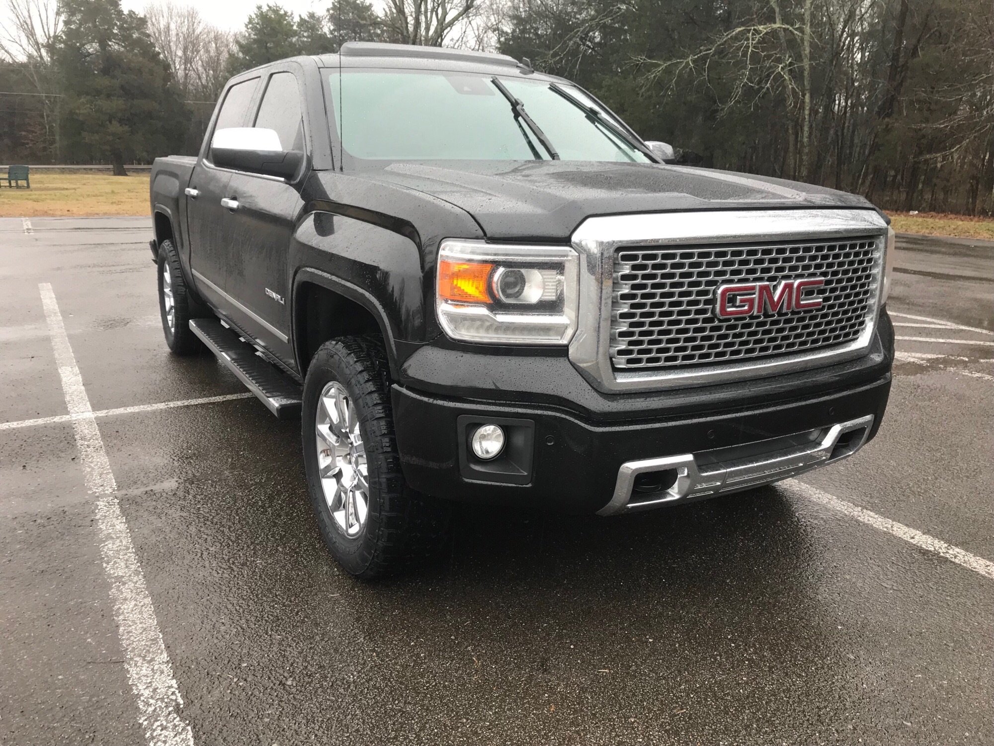

2017 Sierra Elevation Edition, 3 inch Motofab Level kit, 2 inch blocks on rear with 285/60/20 Toyo R/Ts on stock wheels.
Edited by joeglide2017

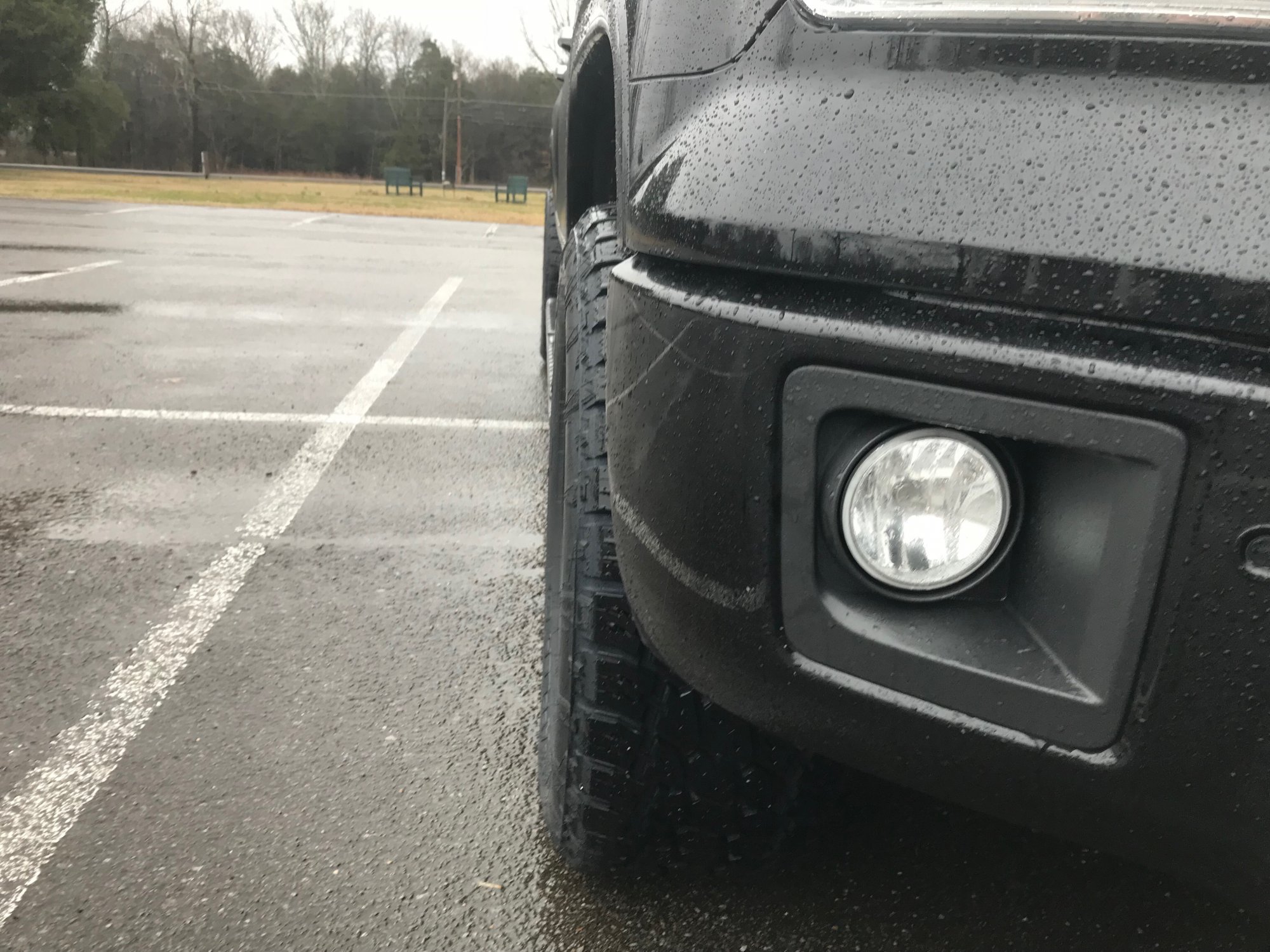

Here is my 17 Sierra Elevation with a 2" level I got from Amazon (aluminum blocks for under the struts) and Nitto Ridge Grappler 295/60/20 on stock wheels.  I can turn lock to lock with no contact to the liners, but I suspect under load it will rub a little.  It does hit the sway bar at full lock, but not too bad.
/28083783689_bccaec7e1d_h.jpg
do you have stamped steel UCA or cast steel?
im looking to run a 2" level on my 17 sierra with stamped steel UCA, just wondering if i would be fine with 295/60/20 on my stock rims as well.
Mine are stamped.  I don't think there is any interference with the control arm?  The tires rub the sway bar at full lock, and just barely touch a spot on the fender liner.  I have put about 600 miles on them so far.

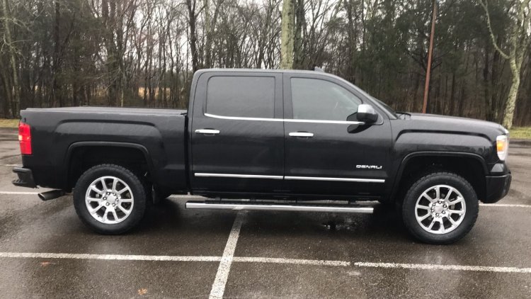

Just had a zone 1.5" body lift added to my 2.5" rc level kit.  Turned out great looks mean but still need a beefier tire and bora wheel spacers or some new wheels with an offset but not too aggressive.
Sorry not the greatest photo yet. Damn snow.
2.5 in level on my 15 SLT.  It sits exactly how I want.  Now for bigger tires.
Edited by Wescraig10
Here's my Sierra with a 2.5" leveling kit. Rough Country 2" lower strut spacers and 1/2" Motofab top strut spacers. Came out just how i wanted. Bigger wheels and tires coming this week

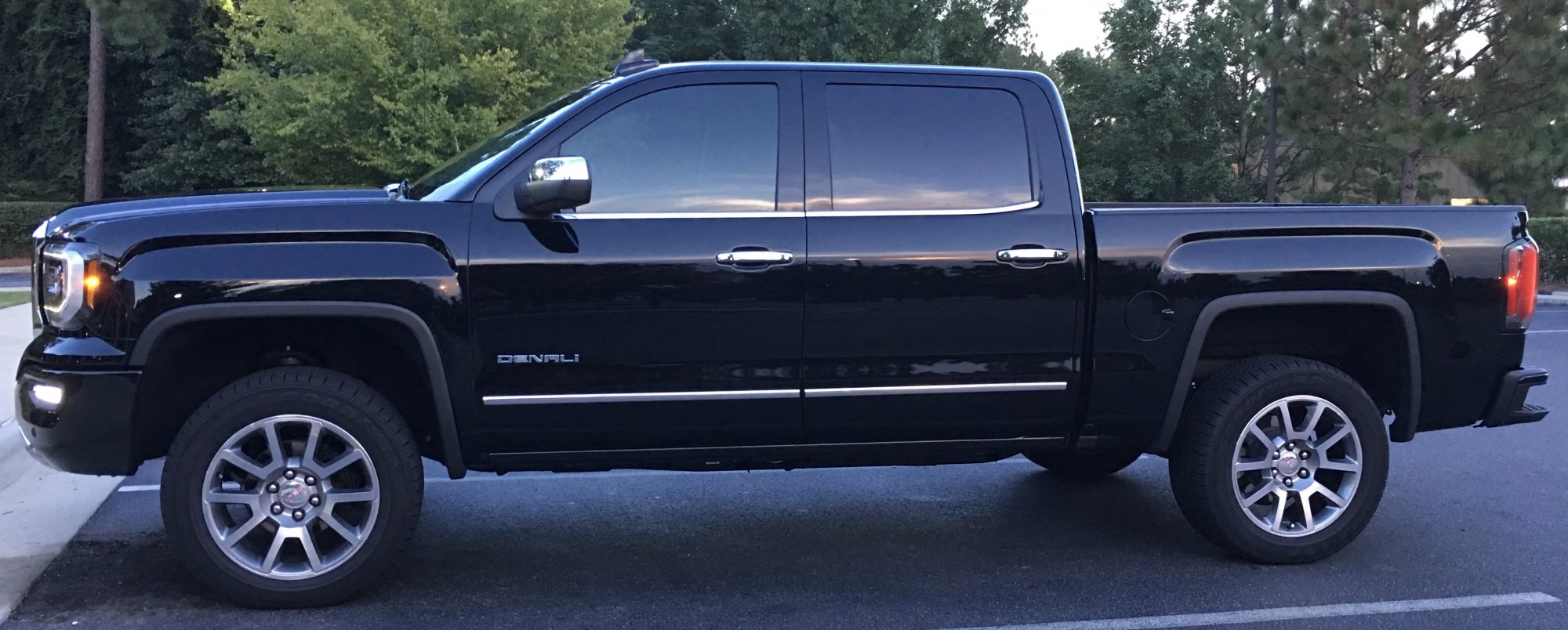

I have a 17 Denali with the magneride and want to keep my 22's.  Im looking at about a 2.5" level.  Which lift is better for the control arm angles;  2.5" spacer on top of the coil spring, and 2.5" spacer on the bottom shock mount, or a combo of the two?  There aren't a lot of options for the magneride.
Won't be any different as far as the arms are concerned.  Longer overall shock length either way.

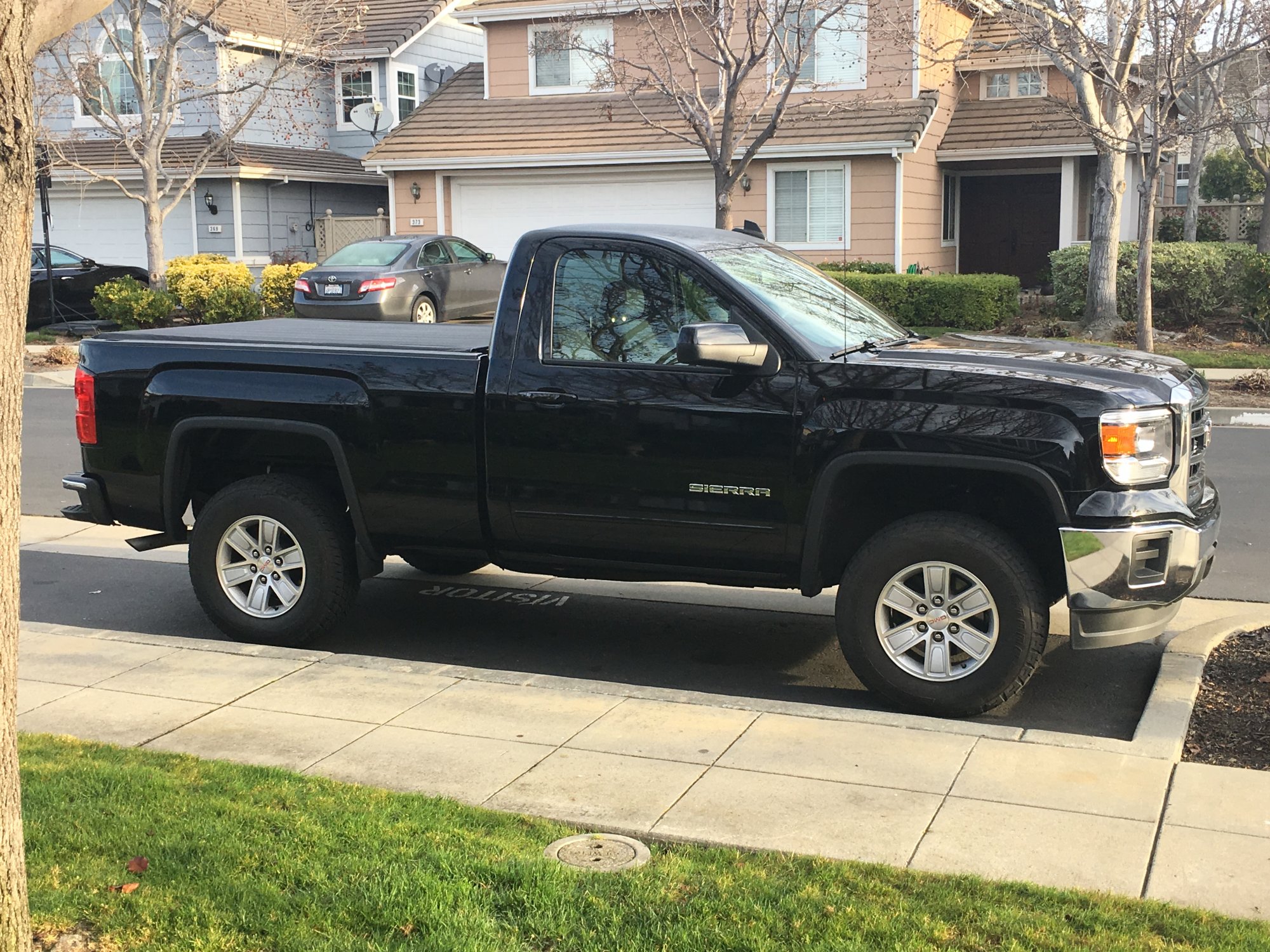

Installed the Rough Country 2" Leveling Kit on my '18 over the weekend. Loving it so far. The picture really doesn't do it justice. The difference is immense. It looks so much better now. My wife says it needs bigger tires now. Who am I to argue?! LOL.
Edited by Skov18

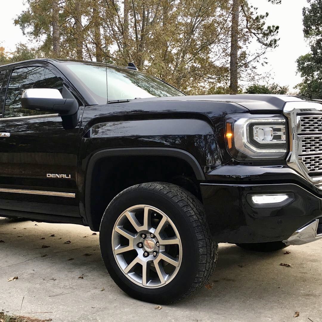

Installed 5100 Bilsteins with 2" Level and 305/55R20 Nitto Terra Grappler G2. The ride is better than Stock which was really good, this thing is super smooth and quiet quiet quiet! I also added 8mm spacers to ensure no rub and I did not have to trim anything. One thing I think folks need to consider is doing a performance balance on their tires and I am absolutely not talking about Roadforce. We took Static down to under .05oz and Dynamic to under .10oz a tire and this thing rides like butter. I am super happy with this set-up!
