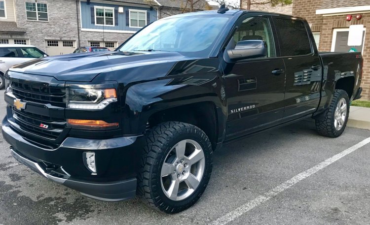

Kept it simple, went with Fox 2.0 on all four corners, adjusted to just shy of 1.5” in the front to keep a little rake. Added Ridge Grapplers in 275/55/20. I’m a little old school, I like to keep it looking a little stock.
  • Like 3
How's the ride compared to stock? And where'd you buy the shocks? Debating between this and Bilstein 5100s. Truck looks good
Love this set up, looking at the same tire and size, any rub and hows the MPG? Ride?
Thanks! It rides just as smooth, but gets rid of that typical “over reaction” to bumps/rough road. Handles bumps/potholes in turns a lot smoother and got rid of that Cadillac float feeling on the highway.
No experience here with Bilstein’s, so I can’t tell you one way over the other, but you can feel the quality of the Fox’s.
I ordered from 4wheelparts, but even amazon has them for $370.
No rub, it’s actually the stock size tire, but is actually a little taller. MPG didn’t change, still getting 19-20 mpg after 200 miles.
Sweet! Im looking to go the same route but was affraid they might be heavy and cause me lose my MPG

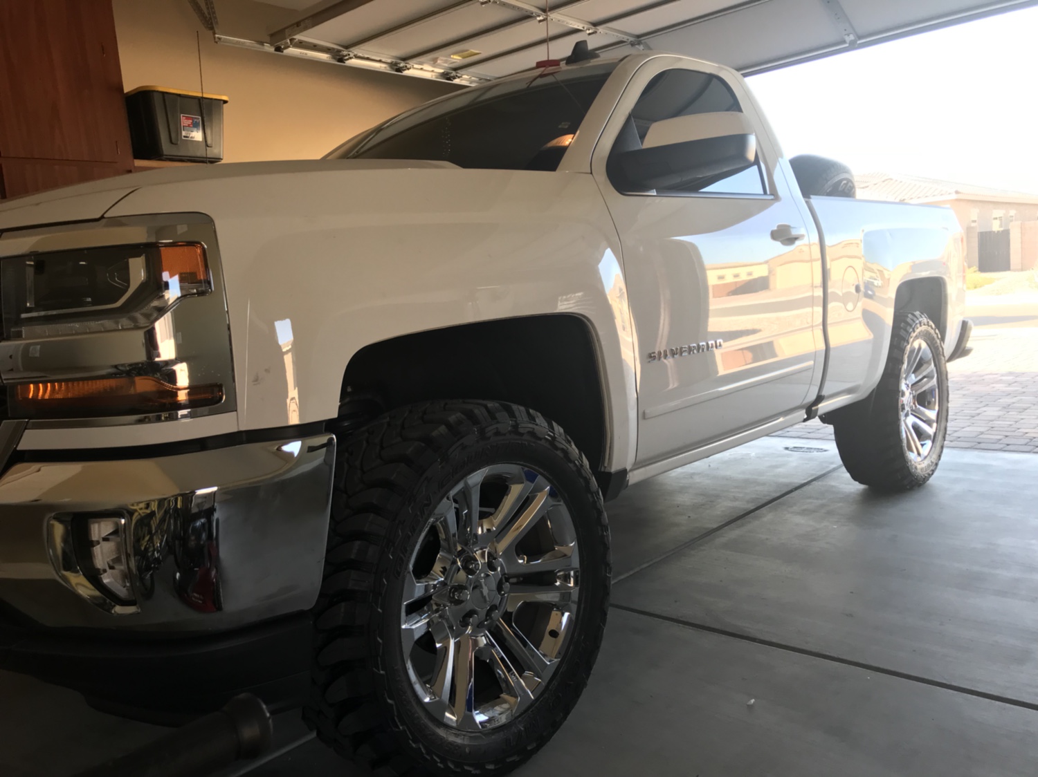

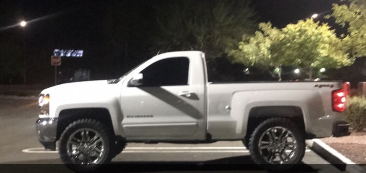

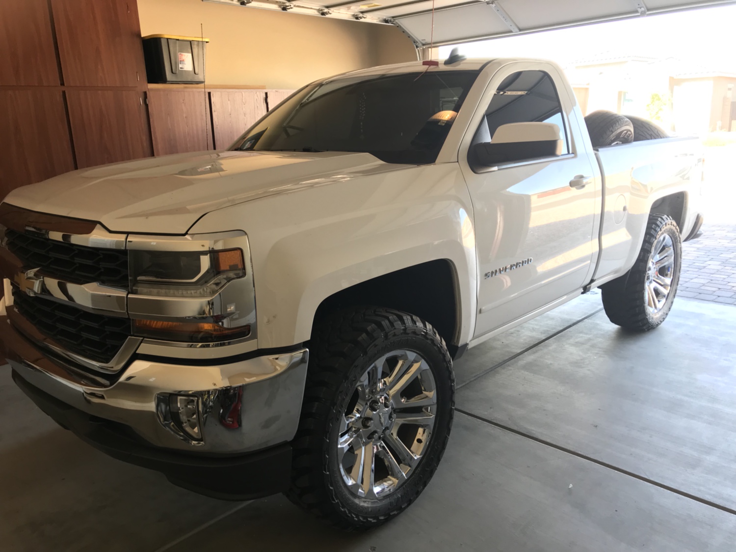

My young brothers set up
3” level up front nothing in the rear
22” factory chevy wheels
35x12.50r22 toyo mt
1/2” wheel spacers in the front
Minor trimming on front
Looks pretty clean if you ask me
Does it clear the UCAs with the 1/2” spacers at full lock?
Anyone running 20x10 -19 and 33’s with just a leveling kit?
Trying to figure out which kit to go with for minimal trimming
Before he installed the 1/2” spacer he would rub at about 90% turn (give or take) after the install he rubs after like 98% turning (again give or take) im just not sure if its from the uca or the sway bar. wen i see my young brother again ill check where the rubbing is coming from
Hope this helped
