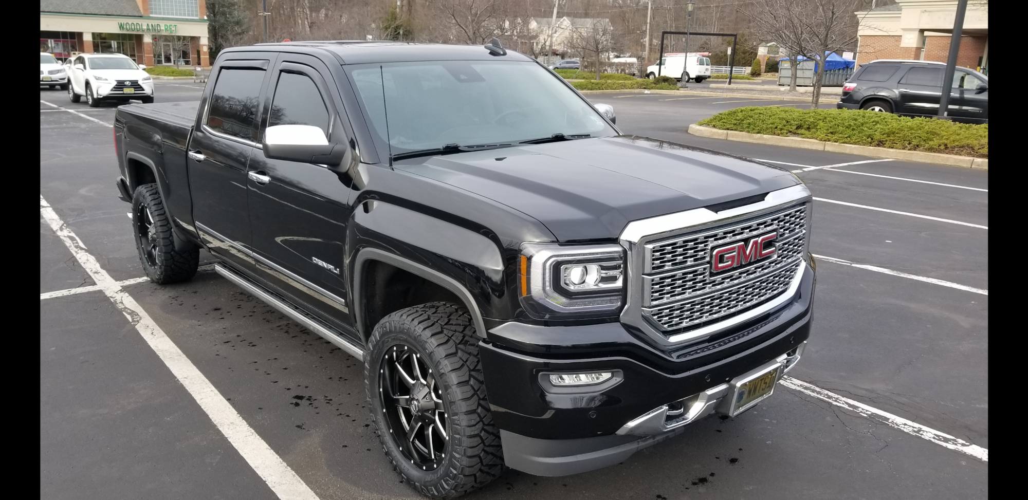

12 hours ago, Jaime Wawatusi said:
Got the new wheels and tires. No rubbing at all now.
Truck looks fantastic!
What size/offset wheels and size on the tires?
295/55/r20 Nitto Ridge Grapplers.    These tires ride MUCH better than the terra grappler g2's and look better.
Fuel maverick 20x9 +1 offset
No rubbing.

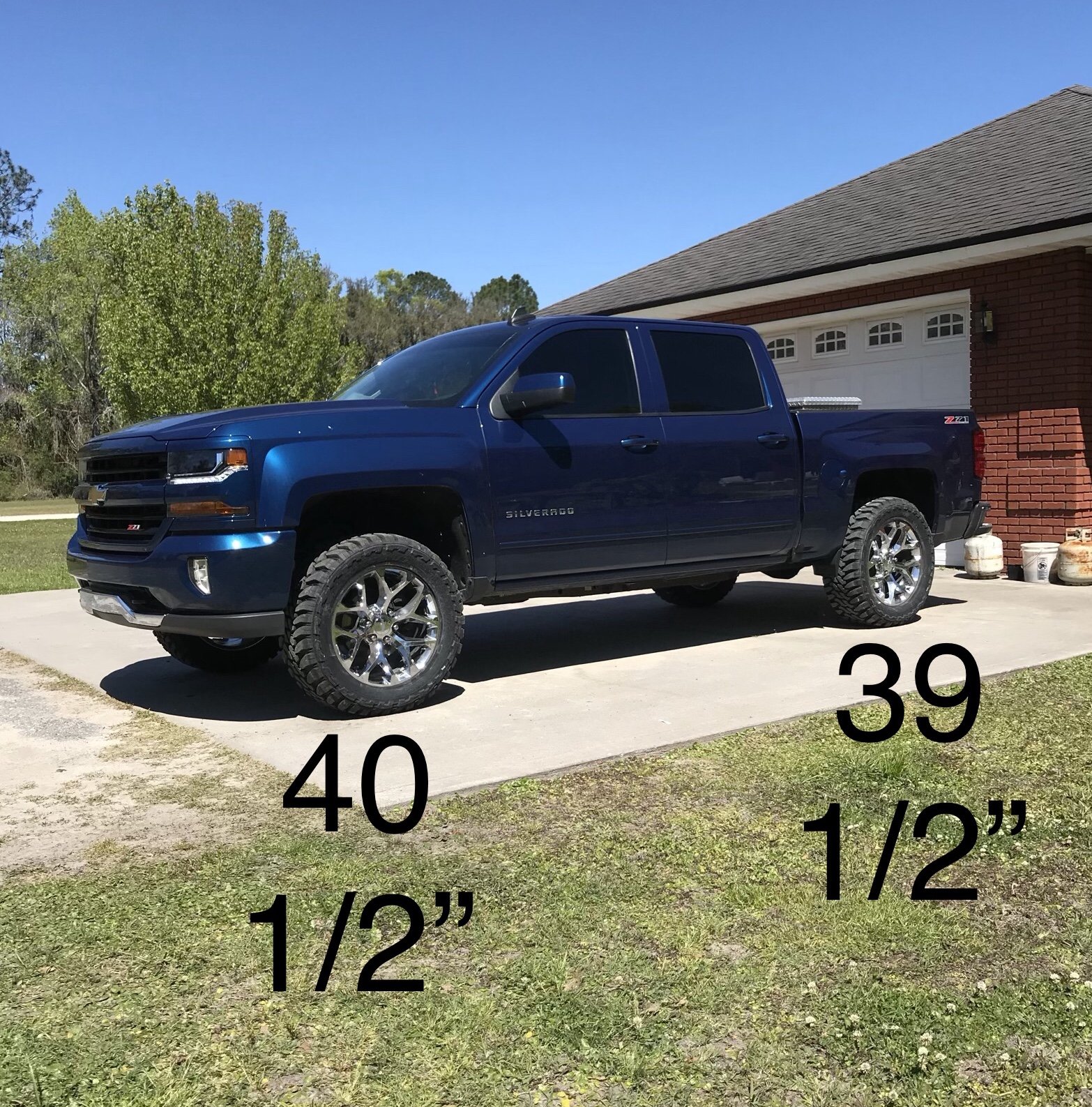

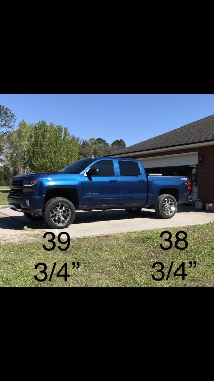

It’s been a little over a year since I’ve wrote in hear so I figured I’d give y’all an update on my truck. 3” Supreme Suspensions leveling kit with stick lift in the rear. 27,000 miles on it now and still no issues. I drive my truck on pavement 95% of the time also so there is no major wear and tear from off roading on the suspension. Truck still rides great, gives me the clearance I want to fit the tires I want. Below are 3 pictures of my truck with 3 different setups on it with the measurements of how tall the front and rear fenders are with the tires an wheels that are pictured. Set one is 20x9 with stock tires. Set two are 18x10 -24 offset motometals with 33x12.50x18 mud claws on it. Third setup is 33x12.50x20 Toto MT’s with the stock 20x9 wheels. As expected the only tires that scrubbed were the Toyos on the control arms. A set of spacers will fix that problem tho. The other 2 sets cleared with no problem at all. Hopefully this helps someone out!

Jamie,
Truck is looking good with that setup...I am on the verge of doing a 2 inch lift on mine as well. I have the black insert 22 inch rims and really like them but it needs more tire around the rim to look balanced to me...Can you post any direct side pics of yours...I would like to see what your fender to top of tire distance looks like as well with the changes. Thanks.

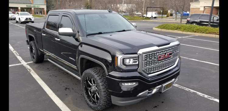

9 hours ago, GMC_SD_Ult_16 said:
Jamie,
Sent from my SM-N950U using Tapatalk
I agree. Rim is too big at 22" to look right. The 20"s look much better imo.
