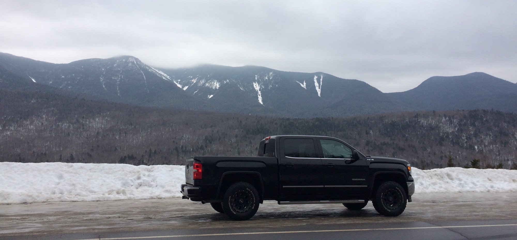

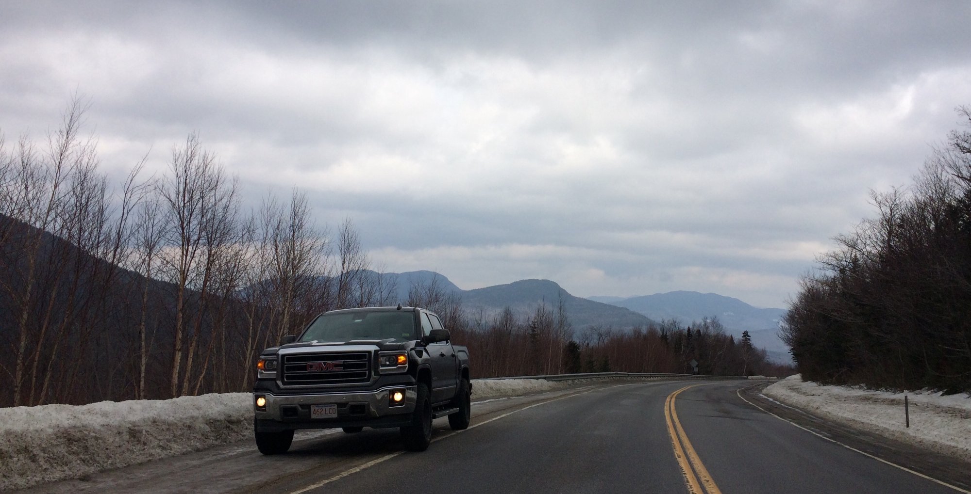

Installed a MotoFab 2" level on my 2018 Sierra today. Took a little over 2 hours. Only ride difference is I can feel small bumps like a gravel road a little more. No difference on pavement. Love losing most of that factory rake. Will be looking into 33's at some point down the road.
Before level:
After level:
Wonder why?
Not sure. He had rub on the carpet liner. I had rub on the cab body mount. Strange because the wheel offset was identical. He was running 295/70/17 and I had to size down to 285/70/17. I still ended up with zip tied and trimmed ponders and mud flaps.
I also subject my truck to a workout off-road. Most of the individuals here who claim no rubbing are in a parking lot or doing a 3 point turn on flat ground. Different animal when your suspension is flexed.
