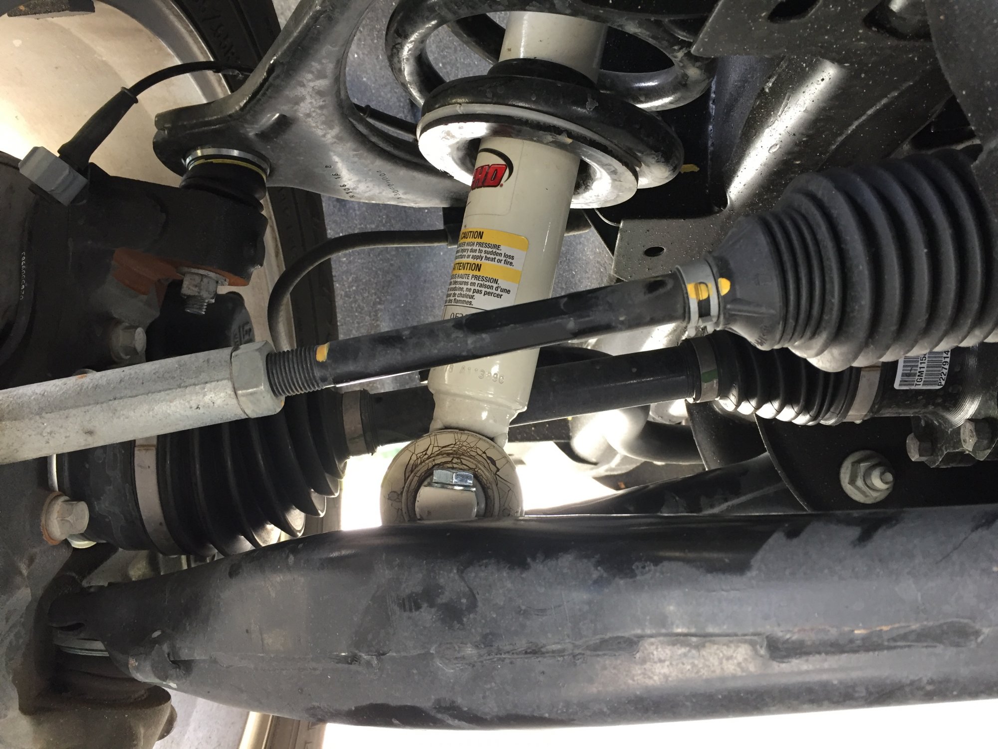

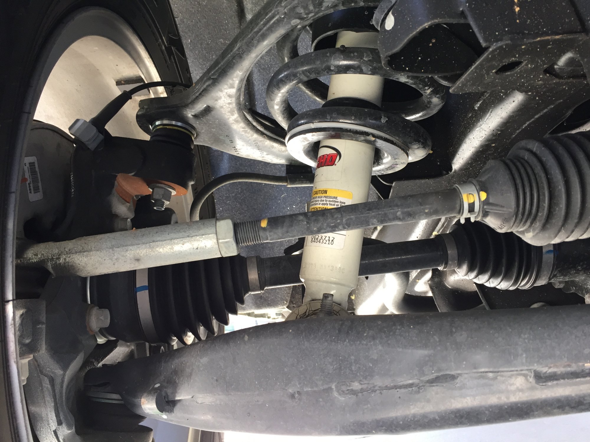

Installed Motofad 1.5” leveling kit today.  In my opinion this is how the truck should have shipped from the factory.  Ground to bottom of from fender before level, measured 36.5” after 38”.  Rear measures 39” so I have 1” of rake which is just right for the truck to sit level with a load in the bed.
I was able to install the spacer blocks by just removing the sway bar links, and loosening the nuts on the top of the strut.  I did not need to remove the tie rod or spindle from the upper control arms. Total project took just over an hour in the drive way all with hand tools.
I debated between going with 1”/1.5”/2” and I think the 1.5” was the right choice for the look that I was going for.
Before and after pics of truck and CV angles.
Edited by 2018Chevyz71
Agree it should come that way. I worked to find the best combo Of above factory while keeping factory ride. Accomplished both with 2” under strut only TGC level kit and 2.25” block in the rear. Love the slight height difference from stock.
