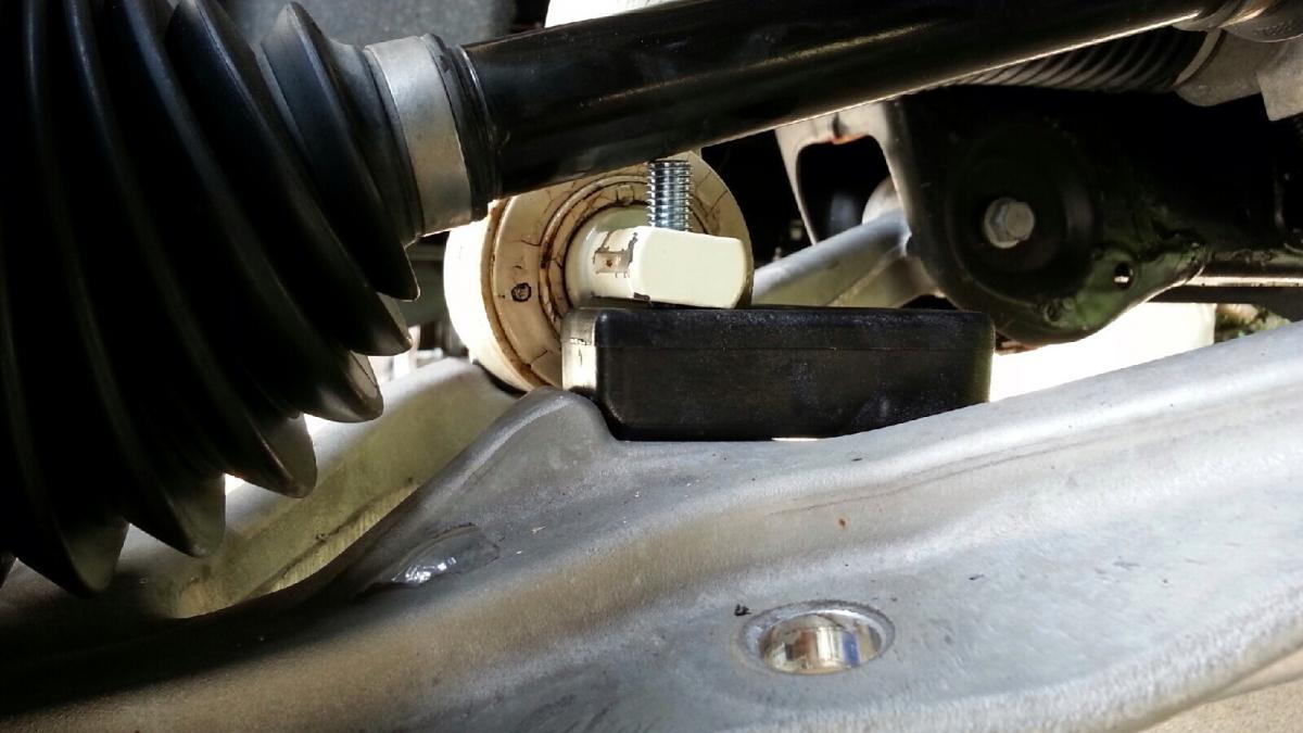

Rough country sells a level kit that is just 2" to the front, that will make it level for you. I just bought one, I didn't want more height to the back.
I know a lot are using the rough country spacer. But, I've also heard that the bolt on each side that is under the axle shafts hit the shaft. So that's why I'm probably leaning towards an upper strut spacer if I do level it. Plus the lower strut mounts that I've seen aren't metal and I don't really like that.

The lower strut spacer not being metal is no problem they have been doing that for years. You probably don't want the spacer to be metal if you have aluminum control arms anyways. It is more difficult to install a spacer on top of the strut then the bottom. As for the bolts hitting the CV shaft, no problem, just do like I did below.
"I had the same issue, one of the bolts would hit the CV shaft if I installed it with the head of the bolt on the bottom per the instructions from Rough Country.
With the upper ball joint and steering linkage ball joint disconnected I was able to tilt the hub assembly enough to get the CV shaft out of the way and then put the bolts in with the head on the top side and nuts on the bottom. Here are some pics.

As for the bolt I don't know why I didn't think of that lol. All of the vids of seen with the RC spacer they do it like the directions say with the nut on top. I saw someone even went as far as to cut that bolt on each side shorter. Not sure if it matters rather the bolt head is on the top or bottom though, but I don't see a problem.
