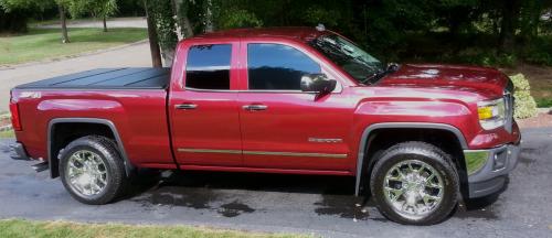

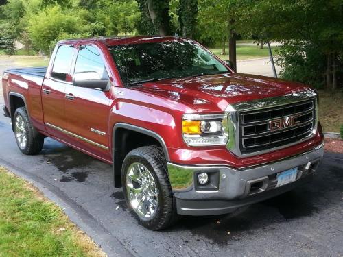

I installed the RC 2 inch lift. I ordered the kit for steel control arms after verifying they were in fact steel using a magnet. I was worried GM might just start painting the aluminum arms. In any case I installed the bolts from the bottom as specified in the instructions and have had no issues with the bolts rubbing on the drive shafts.
My truck had a 4 inch rake for some reason: 36 inches front, 40 inches rear measured center of tire to bottom of fender lip. (Sierra Double Cab Z71). I didn't want to go beyond 2 inches. It's now 38 and 40 and I can live with that.
Very happy with the lift so far.

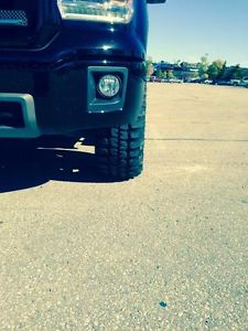

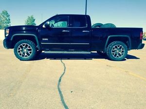

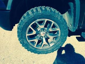

Works perfectly and I'm so damn excited. A very slight rub on the carpeted fender well at full lock. Nothing I'm worried about as far as trimming at all. 295 70 r18 on a 2014 sierra with a 2.5 rough country lift. Trail grapplers great tires and smooth ride for being mud tires.it won't let me upload my pictures. But as soon as I can I will. But I have never been happier that a huge tire fit this good without a major lift. Has milage took a hit but worth it in my opinion lol!
Awesome, can't wait to see some pics. The Trail Grapplers are the tires that I have used in the past, and in my opinion are a great tire. Thank you for the info. Enjoy.

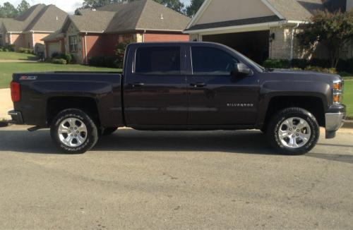

I had a 1.5" kit installed a few days ago. I'm very happy with the results.
My gas mileage hasn't changed. The truck does ride slightly stiffer but it's hardly noticeable.
Pre kit measurements:
Front - 36.5"
Rear - 39.25"
Post kit measurements:
Front - 38"
Rear - 39"

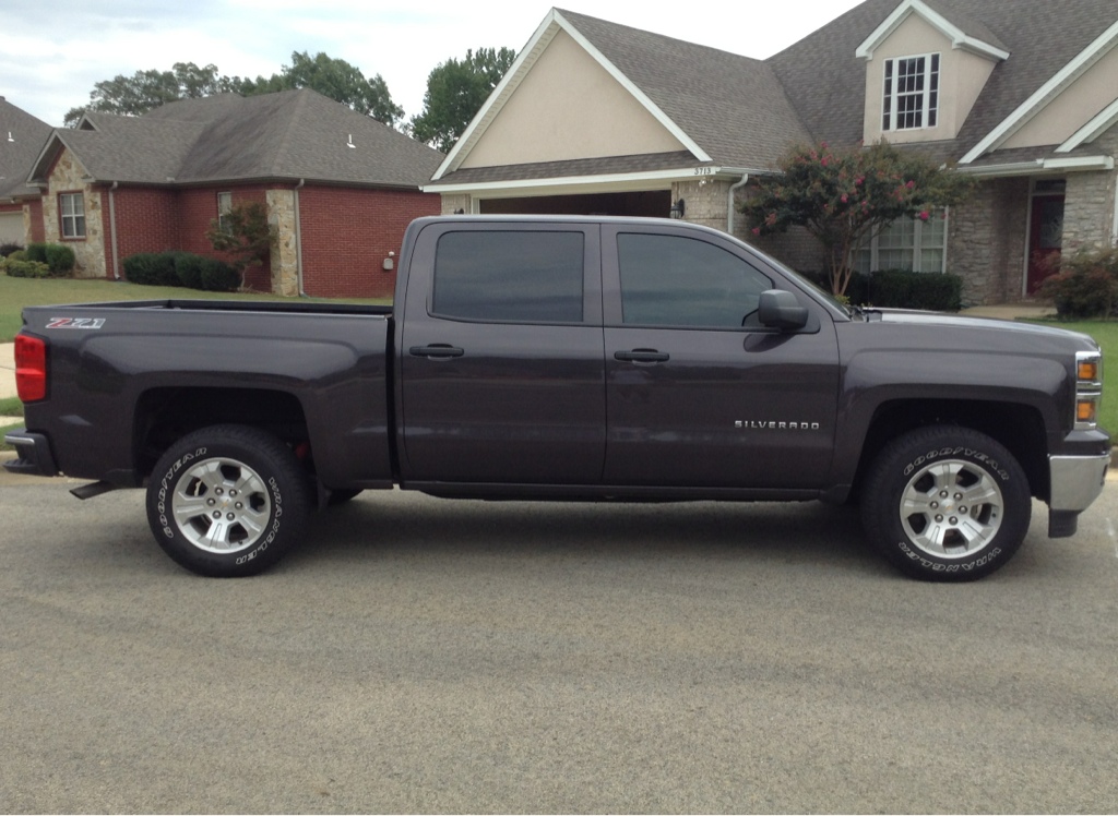

Added the. 5" wheel spacers. Bumped them out just enough to make me happy.
I like your lights! Where did you get them, or what did you have done. Sweet truck!
