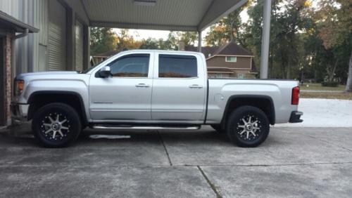

Well I am smiling ear to ear... Just had the RC level/lift 2.5" kit installed. Here is a pic this morning:
And this is this afternoon:
Now for some taller tires!
Did u install the 2" block in the back too? ?
Hard to say for certain, but it looks like the rear is also higher. But is the block with the kit a 2" block or just 1" ?
I believe the stock block is 1" and the kit replaces that with a 2" block.
Did u replace the stock block with the one that came with the kit?
Yes!
