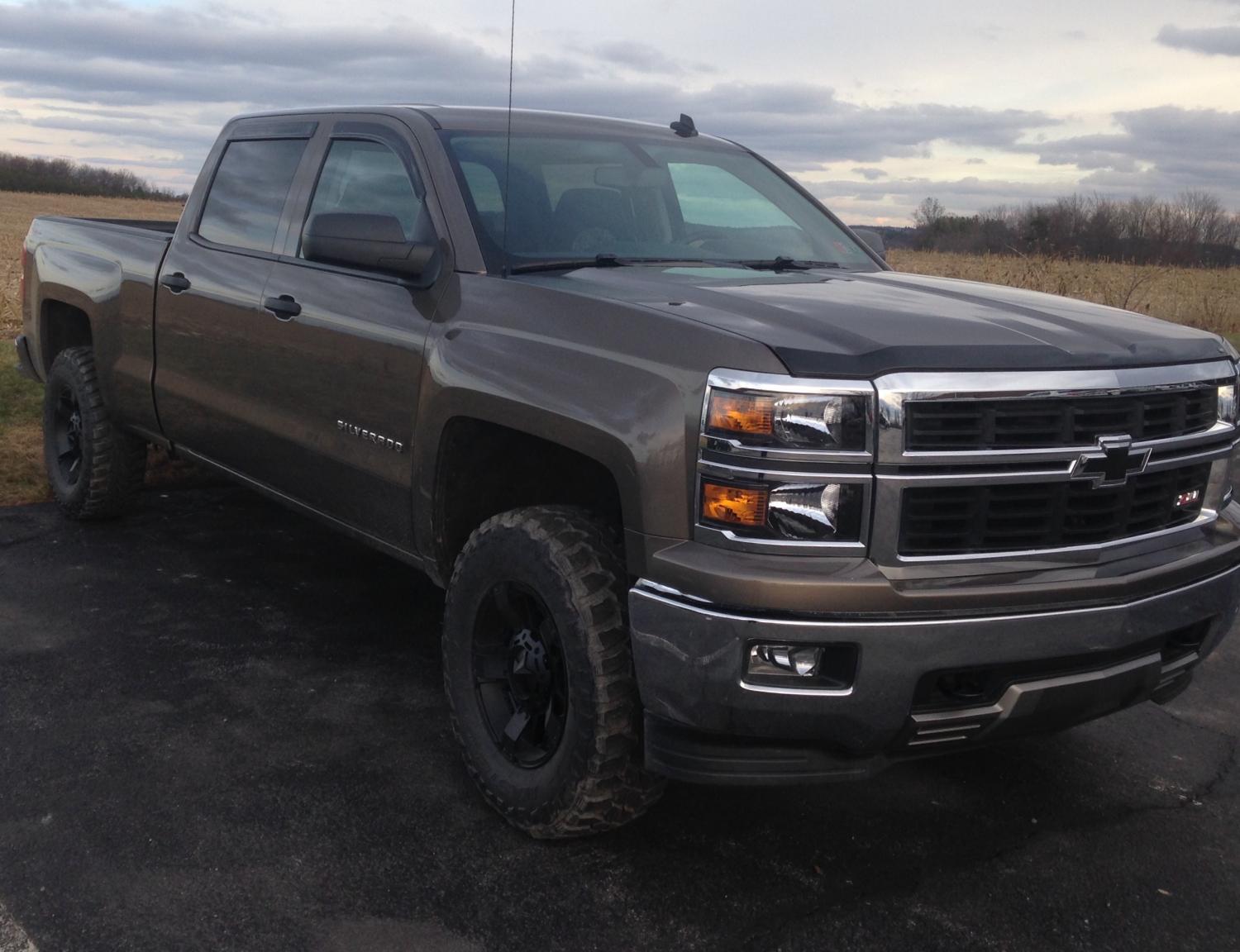

This is my 14 Silverado crew with RC 2.5 leveling kit with 2 in blocks in rear. Rockstar 2 wheels with 285/70/17 mastercraft tires. No rubbing.

Here is pic

Mastercraft courser mxt 285/70/17, I have less than 100 miles on them so no opinion on wear. They have more road noise than what i expected based on reviews i read before buying. I paid $841 to my door from treadepot. They ride a little rough due to being a load range e tire. Havent ran them long enough to give a good review but i love the way they look.

Wow man shiloh that looks great. What color is that Chevy? Metallic iridum? Or Chevy's Equivalent? Let us know how the mastercraft's hold up i've heard good things, considering their price.
Did you do vinyl for the emblem or paint?
Thanks, it is brownstone metallic, bowtie is plasti-dip i still need to do the back and side emblems. Also have black iron cross step bars and bestop bed cover coming. I will post better pics when i get them on and post updates on tires although i only average around 7k miles a year.
