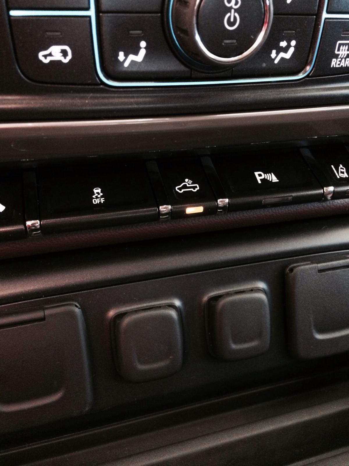

UPDATE: Since they were going to have to take my dash apart to replace the module for the electrical outlet I decided to push the issue on ordering the two parts for the backlighting. I told the service manager that any TSB would require the new parts because of the missing resistors and since they had my dash apart now I would rather it all get taken care of. I asked how one dealership could order the parts for their customer and make it right and another one couldn't. He said he would call GM back and tell them that he had a very unhappy customer and let me know what they said. I got a callback letting me know GM approved the parts replacement and they would be ordering both parts. I left my truck with them and received a call today letting me know both parts had arrived and had been installed and that the backlighting was working fine. A little persistence goes a long way.

For the guy talking about the the cargo light switch, I found a truck at my dealer with it on and I had to ask why does this one work and not mine?

I went to my dealer tonight and found one that had them. They're ok but I'm wondering if I want a tech taking apart my dash for them. It seems every time I have work done on my vehicles they break or mess up something due to carelessness. My 1000 mile oil change resulted in oil all over the valve cover header and frame and oily hand prints on the brand new paint.. Took a while for the burning oil smell to fade.
I understand your dilemma. In my case they already had my dash apart to replace the module that runs the electrical outlet so the dash was already off. Now I have to say I haven't picked up my vehicle because I'm out of town, but I will be going over it very carefully when I get back and will want any damaged parts replaced.
You guys worry too much. :D Both the 110v outlet module and the led lights fixes are very easy to do. Very little of the dash has to come apart.
My dealership has fixed my LED backlighting!!! I'd like to give thanks to Agacmddj1, DTI, and 2happyhicks for being pioneers in this movement.
