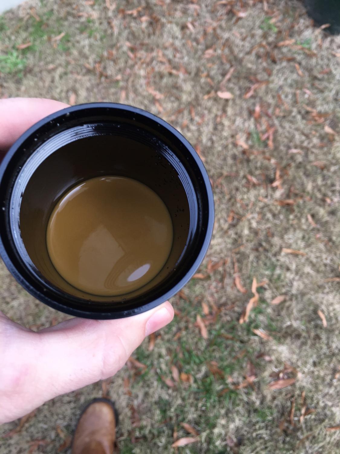

I have not read the entire thread, but I will throw my experience into the mix: the AFM (Active Fuel Management) increases "blow by" on the rings which is then re-routed back into the engine via the PCV. The condensation from the fuel vapors and oil blow by mixture is then returned to be "burned" again. Each time the engine activates the AFM and four cylinders go cold, you will get more oil loss especially if you get on the throttle coming out of afm. There are a couple solutions:
1. Purchase an aFm delete plug and play which does not write/program or otherwise do anything to your ECM from here: http://www.rangetechnology.com( I will be selling mine shortly for $100 once my Diablo Sport Trinity comes in)
2. Purchase a programmer that can deactivate it such as the Diablo Sport, Edge or Bully Dog
3. Have a professional tune
4. Drive around in MANUAL mode
5. Install a catch can to keep that crude from going back into your engine (does not stop oil loss but highly recommend - I get about 2/3 cup every 800 miles when I have AFM on! Plus, you can monitor the actual amount you lose -will try to attach photo of the crude I have collected after only 200 miles of NORMAL driving with AFM active) http://www.eliteengineeringusa.com/elite-engineering-catch-can/
You can read more on Catch Cans here: http://oilcatchcan.com
Hope this helps! Happy Trucking

So if you use the RangeTechnology product or just always drive in Manual, and never let it go to V4, do you still need a "catch can"?
mike5511 - the jury is still out on this. I am still collecting "data" on this. My data will be skewed as I just got my DiabloSport Tuner Trinity and am playing around with it. I will say, with the range tech, I drove about 200 miles and still had some"coffee" in the can. Not as much, but some. I am not sure if there is still some residue left, but once i have more data, I will report back. On a similar note, I am selling my afm delete (only 200 miles on it) for $100 plus shipping of your choice. If interested, please contact me.

Drained a little under 8 quarts on my last oil change, like 7.6. I attribute the 0.4 to oil caught int he catch can, and oil in the filter, and oil i spilled on the floor.
Safe to say my 5.3 is not burning oil
