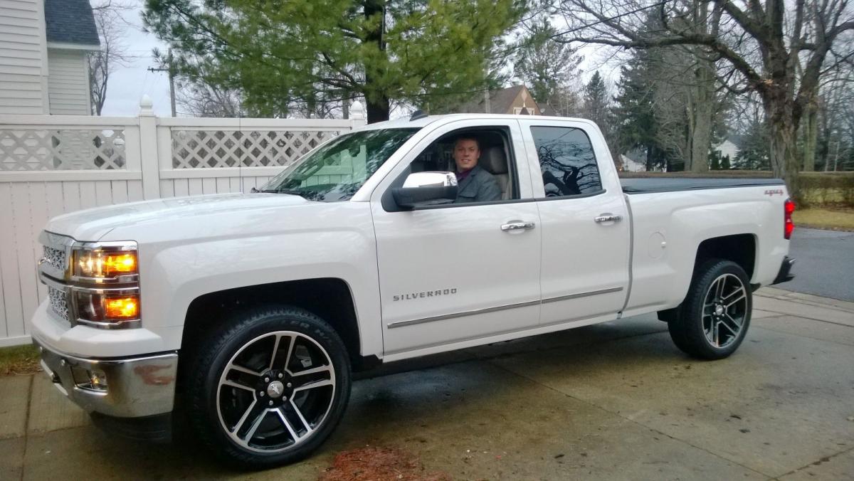

The 22s are why I fell in love with this truck. I think they ride as good if not better than my old 20's, but I do notice a difference compared to my 17" winter tires. Not stiffer, but firmer. But for me....well worth it No regrets!.
