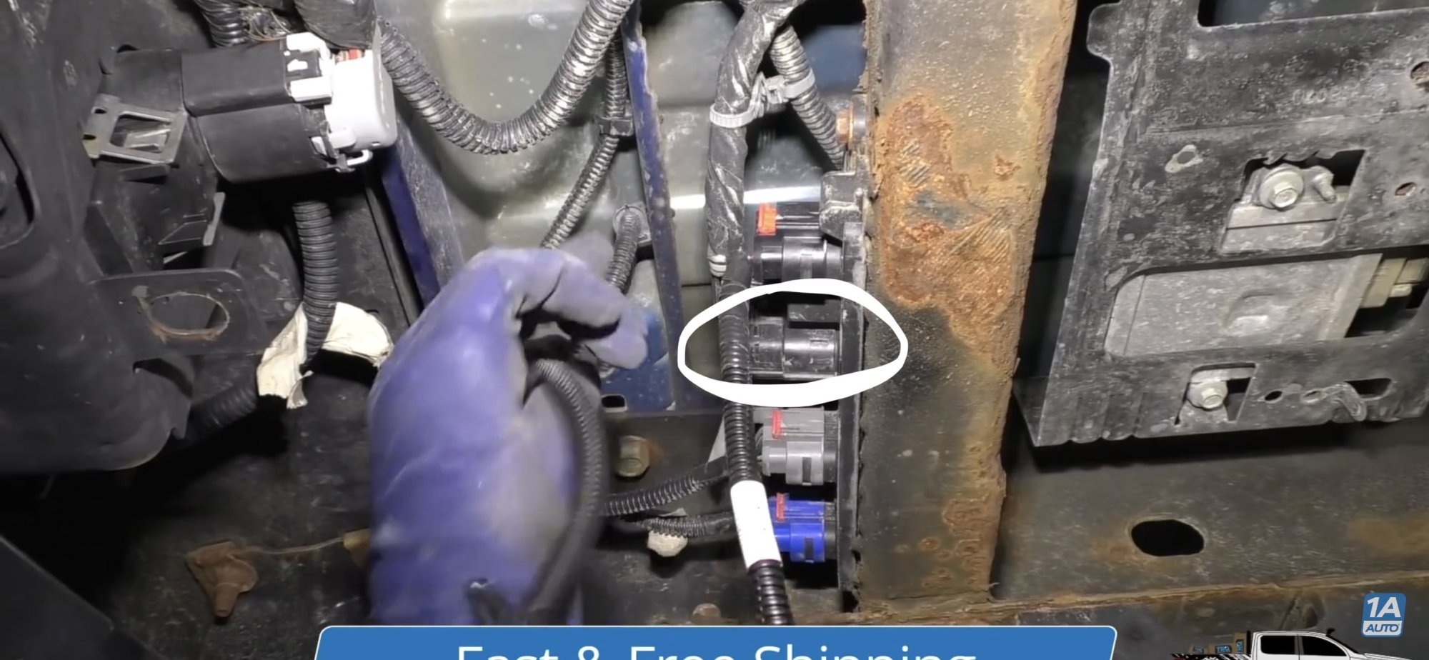

3.  In both instances, you will need a Reverse Camera Adapter Harness that I build.  They can be purchased below:
https://harnessdr.com/product/2014-2015-silverado-sierra-reverse-camera-adapter-harness/
https://harnessdr.com/product/2016-2019-silverado-sierra-reverse-camera-adapter-harness/
Hope this helps answer your questions.  HAPPY NEW YEAR!

Did u get Phil’s reverse camera harness? Otherwise it won’t work
3 minutes ago, 6.2Midnight said:
No, never knew about it until I seen this post...
order that harness should fix u up, ? I wondered the same shit when I got mine back but it requires a harness ? easy to install right under the bed by the spare tire
Edited by Frankielozano214
Thanks for the information, just ordered a harness.

Thanks for your order. Sorry to hear you had some issues with WAMS. One of the reasons why I offer this harness now is to help WAMS and their customers with this part of the unlock.
There are no instructions with this. But it is really simple. Under your bed, there is a junction where your tail lights, cargo light, and tail gate harnesses plug into. Find the tail gate one (it’s have different braiding on it). Unplug it and plug mine in between.
