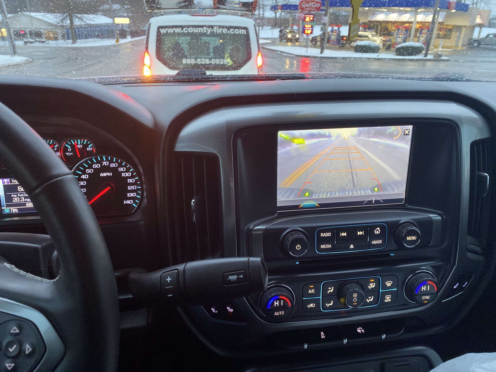

Ok.  Here is the explanation of this.
The mod here is accessing your reverse camera.  The factory method is that it only comes on in Reverse.  The mod is performed by having your HMI "Unlocked".  This is done by WAMS - www.whiteautoandmedia.com
Once the HMI is "Unlocked", one of the features you gain is a "Camera" icon on your 8" Screen.  What this does is give you the ability the call up the reverse camera at any time.  It will function as normal where it comes on automatically when in Reverse.  What is neat about this mod, is the ability to call it up while in Drive.  Neat for when towing and you want a quick look on the trailer.
Now - With all that said, there are some prerequisites here.
1.  You need a 2.5 HMI and 8" screen.  This means for you 2014-2015 Trucks (and some 2016 Trucks that got the leftover 2.0 HMI hardware), you must upgrade to 2016 - 2.5 HMI Hardware.  This is known as the "CarPlay/Android Auto Upgrade".  This service is provided by WAMS - https://www.whiteautoandmedia.com/product/2014-2015-5-c-k-platform-car-play-upgrade-retrofit-programming/.  They can also supply the hardware if needed.  There is a SPECIFIC upgrade path with compatible part #s that makes this truly PnP and fully operational.  While you have them perform the CP/AA upgrade, you can (at the same time), request to have the full UNLOCK done - https://www.whiteautoandmedia.com/product/2013-hmi-based-radio-iwm-unlock/.  These are separate services that need to be combined IF you want to gain the full HMI Unlock features.  I made a video of those features here -
2.  For those of you that have a 2016+ Truck WITH the 2.5 HMI, you can remove the HMI and send it off to WAMS to get UNLOCKED.  If you have 2016 truck and you remove your HMI, it is likely that your truck will not start.  I made a video and have a bypass to start your truck while your HMI is out (this does NOT affect 2017-2018 trucks - you should be able to start your truck without your HMI).  Once the HMI is sent off, WAMS does their magic and send it back to you.
3.  In both instances, you will need a Reverse Camera Adapter Harness that I build.  They can be purchased below:
https://harnessdr.com/product/2014-2015-silverado-sierra-reverse-camera-adapter-harness/
https://harnessdr.com/product/2016-2019-silverado-sierra-reverse-camera-adapter-harness/
Hope this helps answer your questions.  HAPPY NEW YEAR!
My 2016 has Apple Carplay as an option under settings on the screen. I have an Android phone, so I've never used this, nor have I added Android play. Questions is, since Apple Carplay is an option, does that mean I have the 2.5 HMI?
Yes. You should have the 2.5 HMI with CP only. To gain Android auto, it needs to be updated.

That's what I thought, just wanted to confirm. Really not interested in the android update, but the rear camera update has me thinking...

It’s great if you have a trailer or just to check on the guy behind you.
