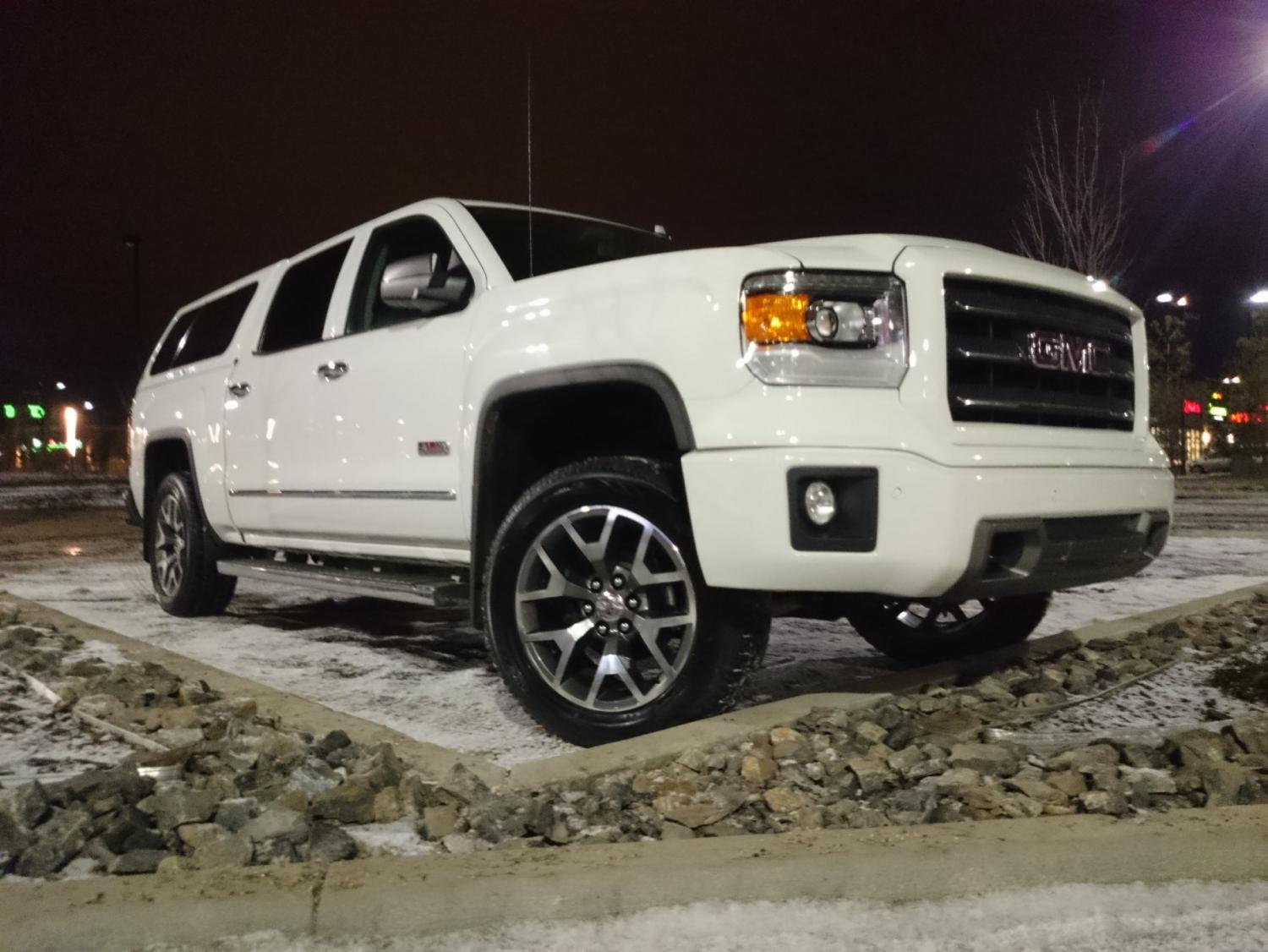

Got the GPS issue fixed and detailed yesterday (Yes, I noticed the condensation, spent 2 hours that night till 2 AM drying everything up lol):

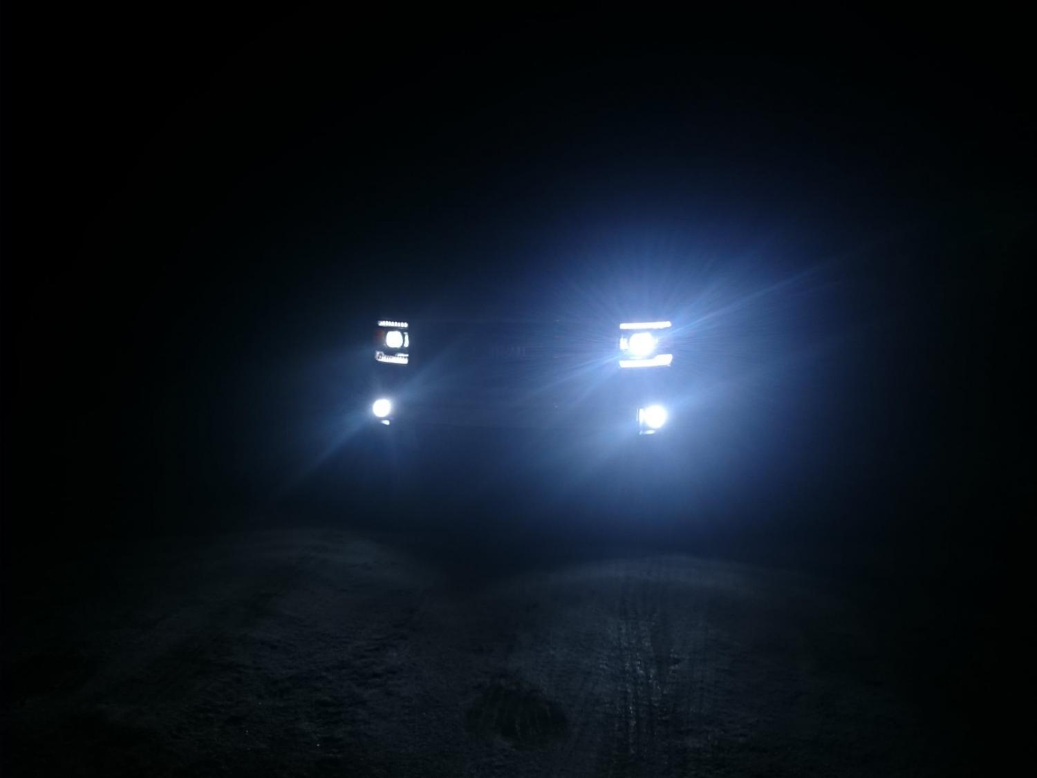

Removed the amber running signal and replaced the signal lights with LEDs
I should've kept that amber running light trick to myself! It makes the truck look so much meaner.
Mike , please do share :) how did you do this ? Thanks broski

Cut the wire.
Which wire? Would this work with the Silverado?

Looks like a mean transformer without the yellow light. [emoji106]
^Yes I would like to know how you disable those lights toooo!

For the Sierra you'll have to pull the headlight out to make this a lot simpler. DangerDick is correct, you have to cut the GREEN wire on both sides as that is your running light wire.
I have some wiring running back into the cab now that allows me to turn the ambers on and off when the running lights are on so if I ever want them on, I just have to flip a switch [emoji4]

I have the VLED V3 triton. I really like how this set up works because it makes the blinker much more noticeable (well, mine is easily noticeable without the disabling mod cause it's so damn bright!)
You will NOT get a hyperflash and NO OTHER FUNCTIONS WILL BE AFFECTED. The only thing that will happen is you will no longer have amber running lights [emoji106] as I said, turn signals and hazards still work just fine.
