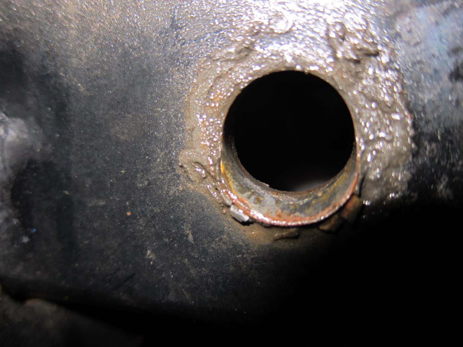

Here's my OEM hitch ... left side pin hole, worn up and down (as opposed to front to back).
Guess I know what I'll be buying to replace it! Thanks guys! :cheers:
