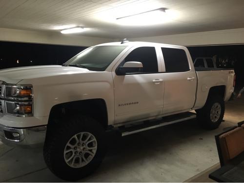

Stock gmc 18 on 35x12.5 bf
Need some more details! Lift? No hub knuckle rub with stock rims? Metric size or 35x12.50r18?
Edited by bcbz71

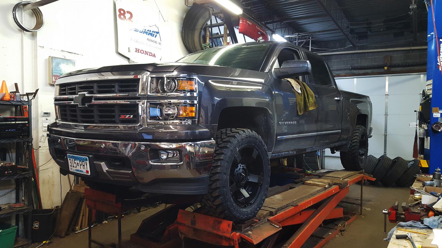

I've got a 2014 Silverado Z71 LTZ. Added the Rough Country 2.5" leveling kit, 20x9" Rockstar II wheels with a -12 offset, and 295/55 Toyo Open Counry M/T tires. Rubs a little at full lock right now, especially in reverse. I have aftermarket bumpers coming that should fix most of it, and will need to do a little trimming for the rubbing while in reverse. I'll try to take pics of the rubbing/trimming when I get some time. For now, here's a few pics of it in the shop (all I got for now) as well as some pics to show how much it sticks out with my setup.
