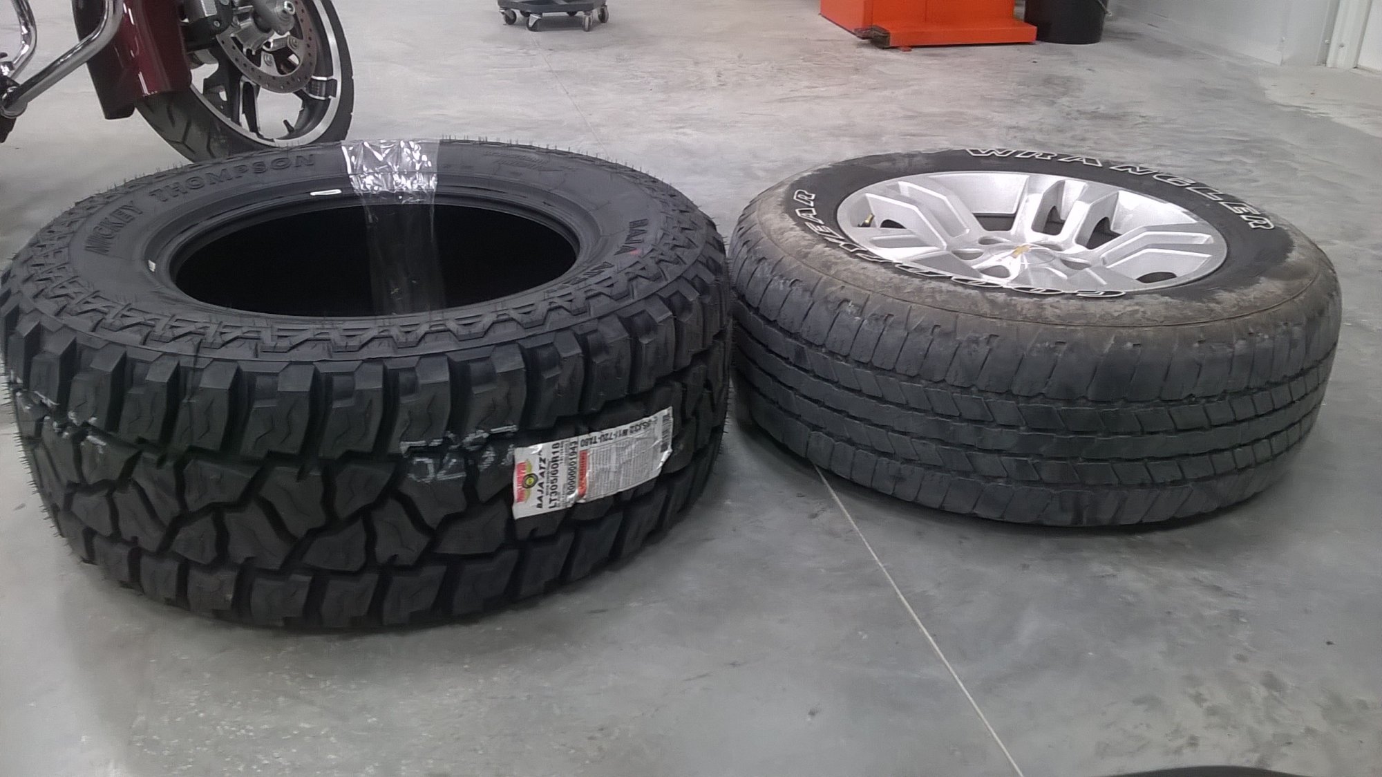

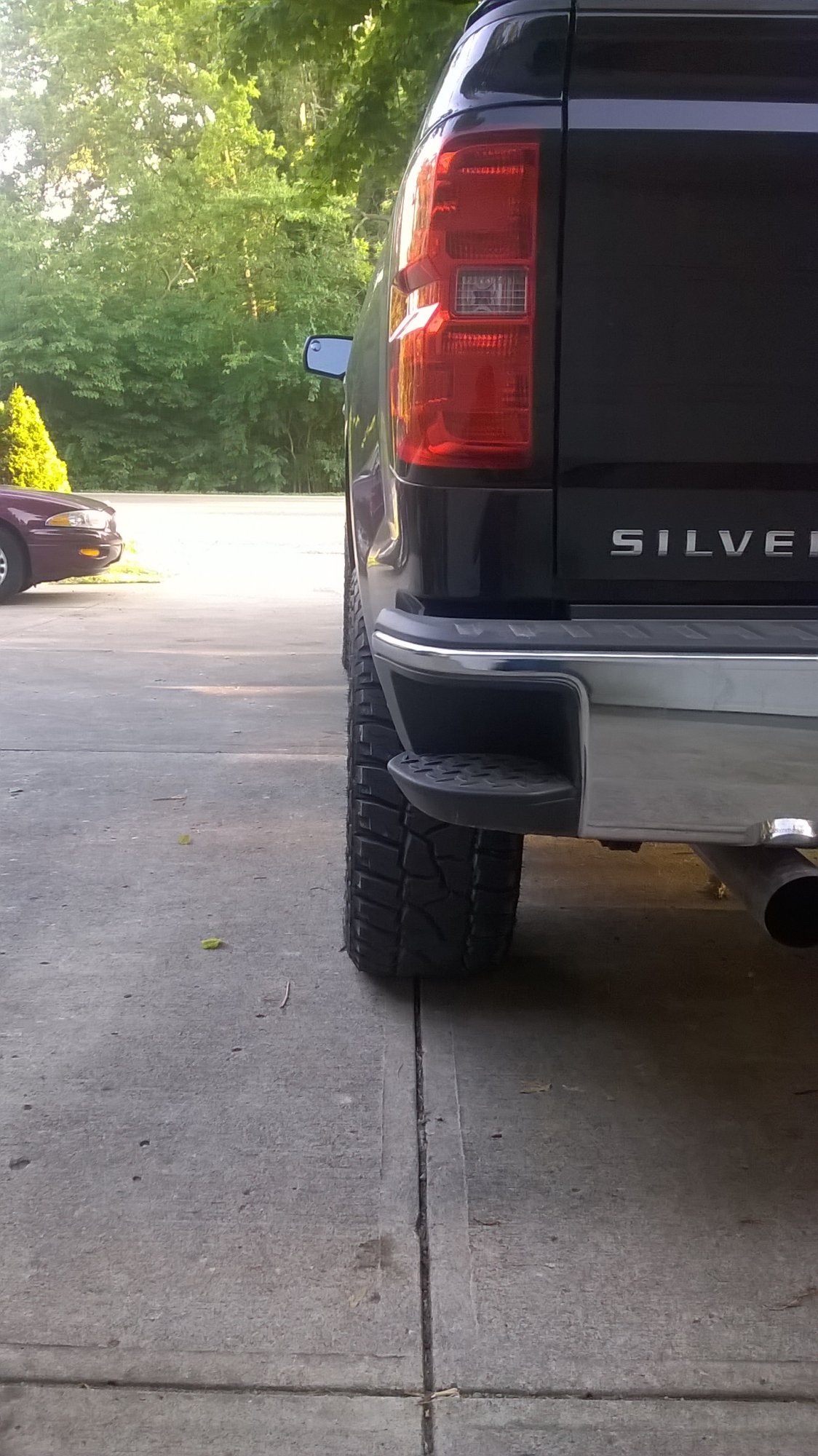

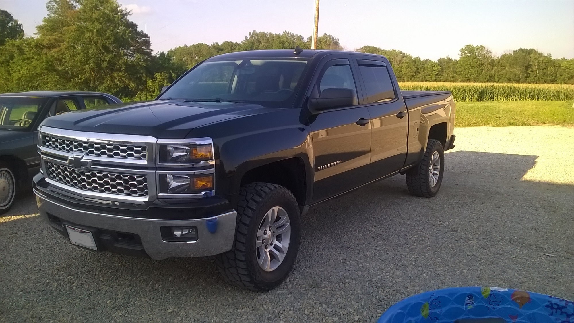

2014 Silverado 4x4 LT Crew Cab Std Bed; RC Lift: 2.5" Front 2" Rear; Tires: Mickey Thompson Baja ATZ 305/60R18;  Wheels: Stock 18x8.5, Factory Offset
Undetectable rub while driving in any configuration (towing, reverse...) , but minor paint rubbed off of sway bar.
