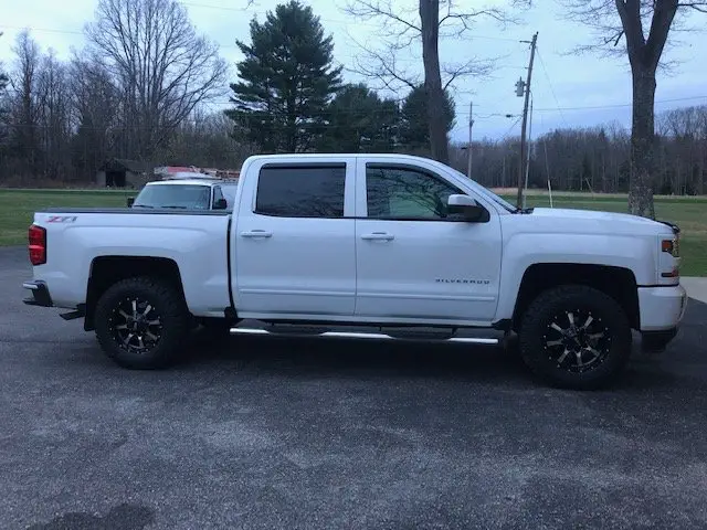

Moto Metal 970's 18x9 with 18+ offset BFG K02's in 285/65R18. No rubbing anywhere. Even at lock both directions. I just have a 2" level on the front. I know they are not real big tires but I am really happy with how it improved the looks of the truck. Front tires are just even with the fender lip now, rears are tucked in a tiny bit.

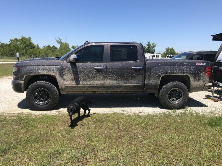

18x9 ultra hunter +18 offset
295/65 wrangler duratrac

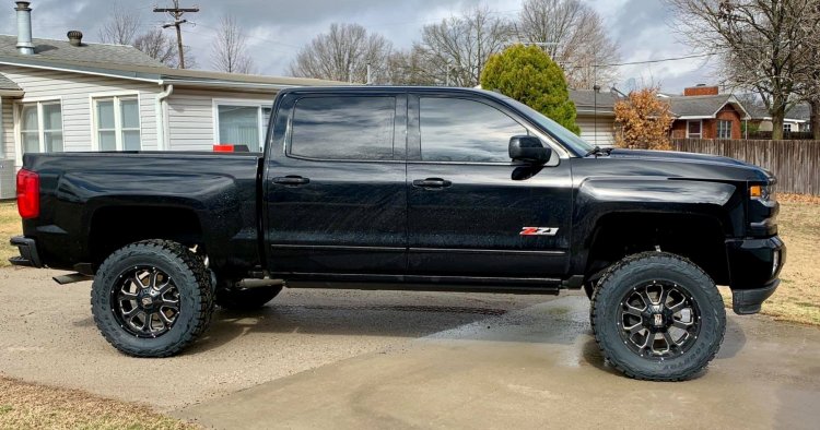

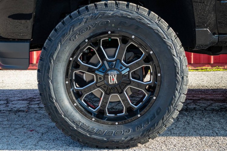

6" BDS lift
20x9 XD 825 Buck Wheels
35x12.50x20 Toyo Open Country R/T's
49784174_2032998170326245_8752474644314849280_n.thumb.jpg.fa19d02ffb568e9f2de23baafdf2618b.jpg

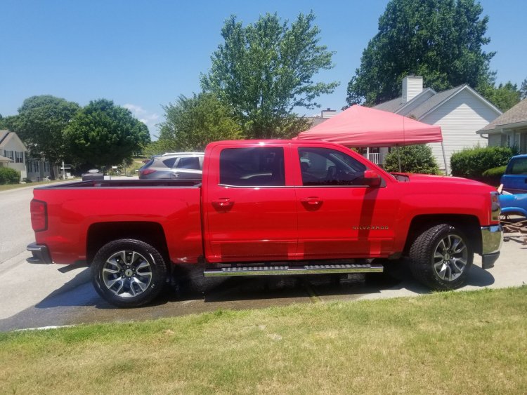

2019 Z71 wheels on my '17...factory bridgestone 275/60/20 tires...stock height

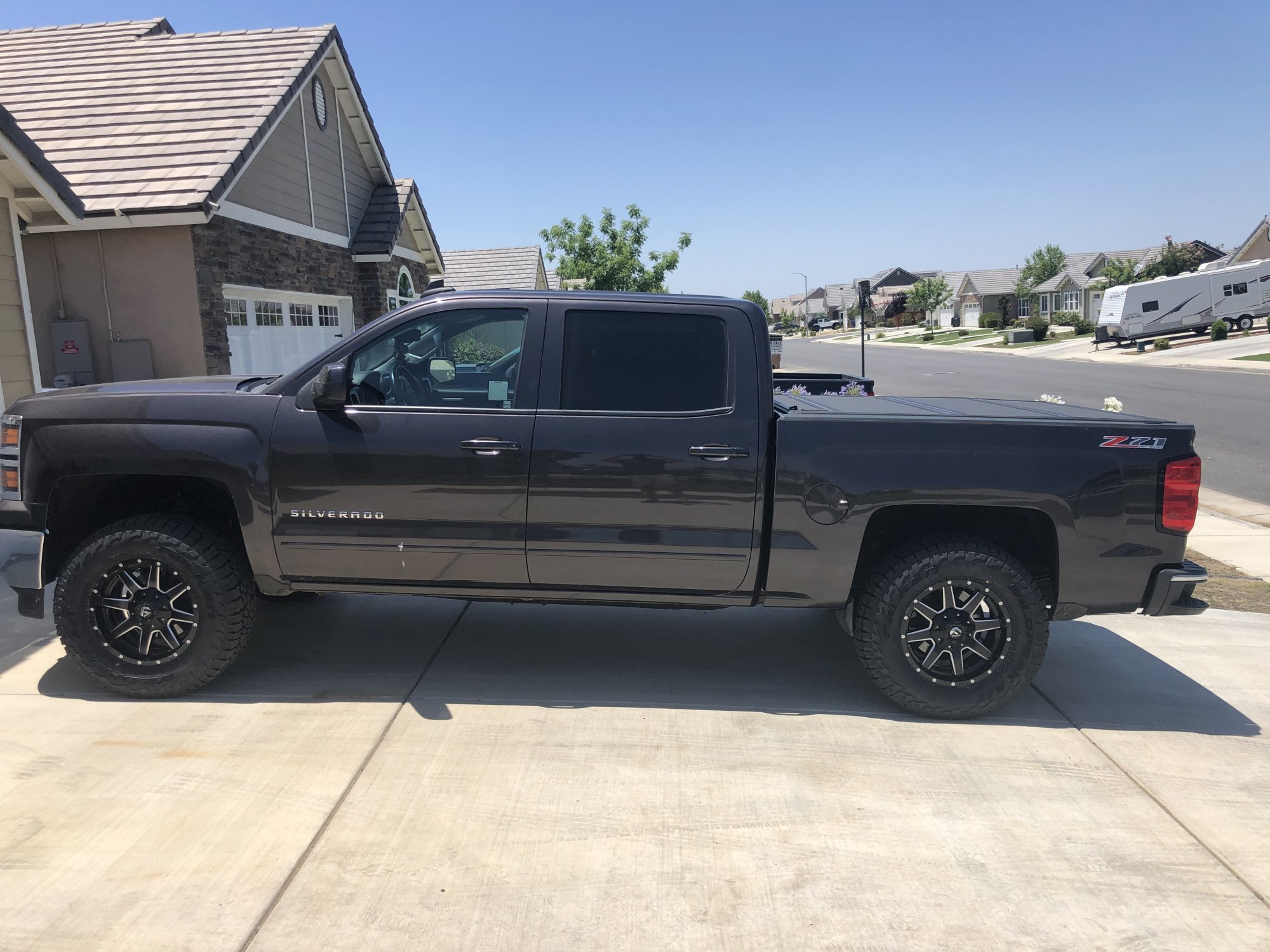

2015 Chevy
18x9 Fuel Mavericks +1 offset
305/65/18 Falken Wildpeak AT/3s
2.5” motofab up front. Still need to install the 2” blocks in back
No rubbing issues.
