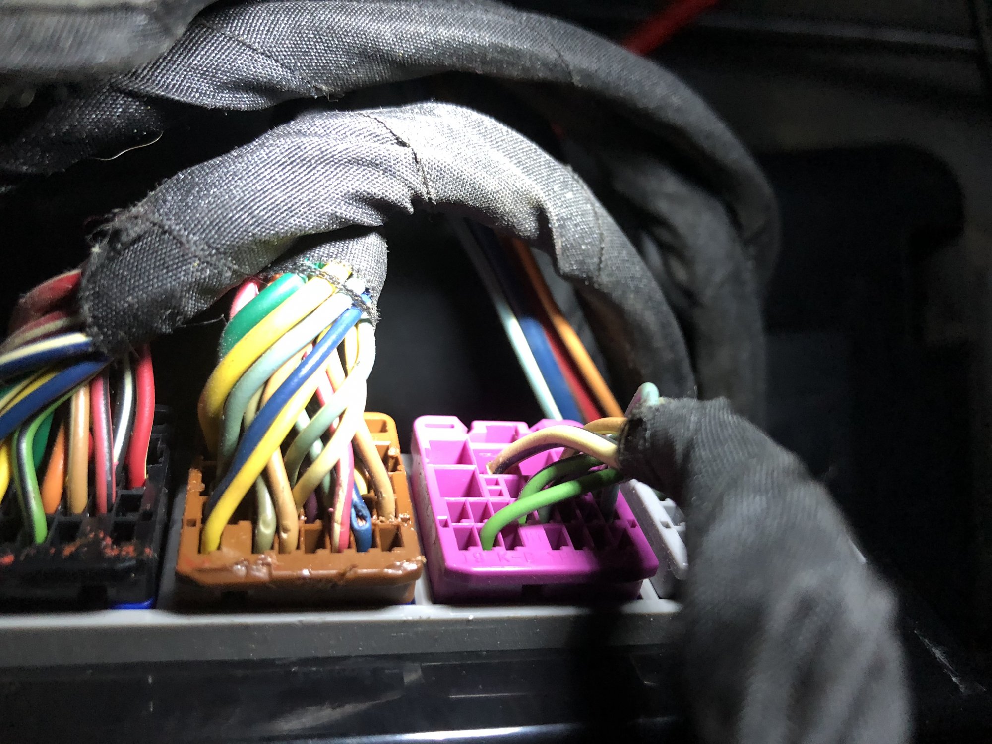

Alright so I’ve been really wanting to do the cargo light - reverse light mod but i can’t find the right wires in the BCM. I can’t tell if the original post is for a NNNBS, but I have a NNBS. 2011 Silverado 1500 Z71 if that makes a difference. I’ve searched all over google and can’t find a diagram. Here’s a picture of what my BCM wires look like. The site won’t let me load more than one pic. Any ideas?
BRN26 to PNK26 (there are 27 on PNK), on the 2014s and newer, this forum.  You will need to find a wiring diagram or check with other 2011 owners.  PGamboa may have a diagram for yours already.  I downloaded and scoured the PDF for 2011 electrical build, could not find the information for jumpering your cargo lights and reverse lights.

Daneal,  I attached a picture of my Reverse/Cargo connection.  Make sure to also push them in at least 1/4"-1/2".  If you did have the diode backwards, then your reverse lights will come on with the cargo switch.  Also, if you are only going cargos on with reverse, your cargo light switch will also light up in reverse.  Freaked my son out one night, and for a short second, me.  I used the smallest phillips tip jewelers screwdriver I have to create a passage for the wire on the diode down along side the pins/wires I was inserting the diode into.  Pushing the diode wire in can be a little bit of a PITA, without creating a "tunnel."
1 hour ago, JONES424 said:
I do not have an answer for you but what happened to your wires?
No idea. This is my first time looking at them and i found them like that
Def some repair work..that will be a little bit of a job..:(
I don’t think I’ll be messing with it, I guess it’s been like that for a while cause everything still works as it always has.
True..could always put a little liquid tape on the open ones at least that would close it up..just a thought..

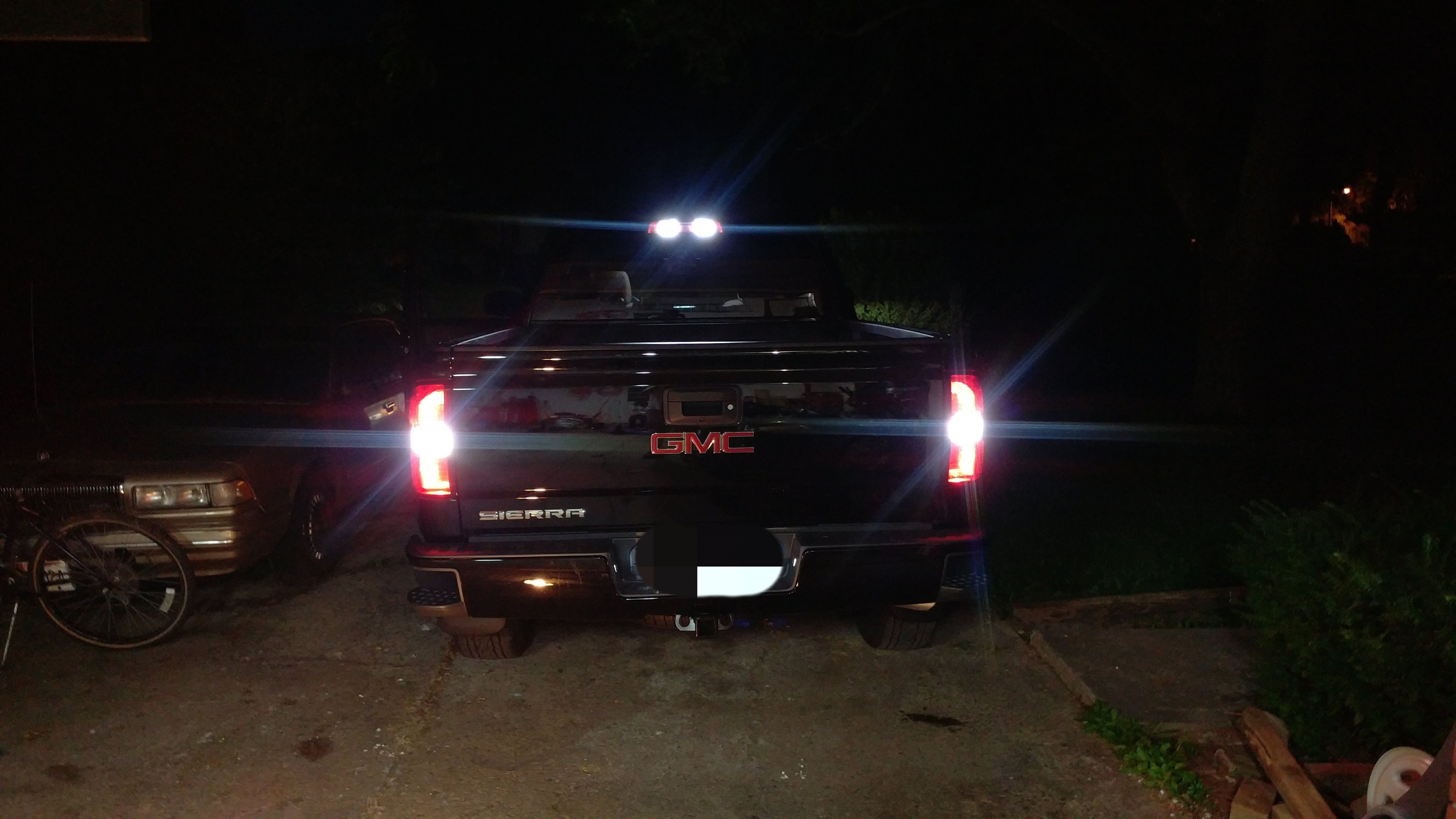

I just have to say thanks to the OP and the rest. Just did this on my 2017. Used a piece of single-strand 24ga hookup I had laying around.
I got a nice set of LED backup and cargo replacement bulbs from eBay (link will be below), right after I picked the truck up because (esp in the rain) at night my backup camera was useless. They helped, some. I hit the seller up (had one of the plate lights go out) and asked about some brighter reverse lamps, and for an extra cost he shipped me a pair to try. Much better, and then when combined with the cargo lamp hack found here, it's almost as bright behind the truck in reverse as in front!
https://rover.ebay.com/rover/0/0/0?mpre=https%3A%2F%2Fwww.ebay.com%2Fulk%2Fitm%2F182525013600
This link is for the original reverse lamps and cargo bulbs. I am asking the seller for an updated listing for the new reverse lamps and cargo bulbs. Will update when/if provided.
Here is a pic of the original upgrade reverse lamps to compare.
