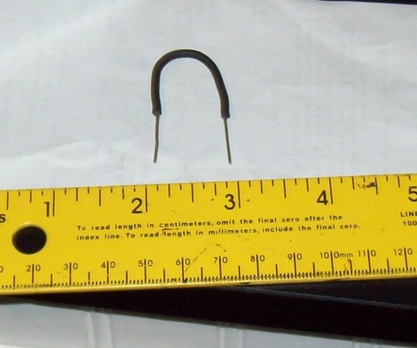

Here's what I did. I wanted mine to work in both positions, come on in reverse and with the switch the back up lights would light.
So all I needed was a wire that would fit and not fall out. It's a paper clip with a piece of shrink tube on it bent in a "U" so you can push it in there.
Guys were having trouble with the diode because the wire is too thin, you only need about a half an inch of wire exposed.

I had this on my 2015 GMC Sierra for 22 months, never had an issue. For the jumper I used a piece of thermostat wire. As a matter of fact I took the wire out when I trade in my 15 for a 2018 GMC Sierra and installed it on that one. Working perfectly currently.

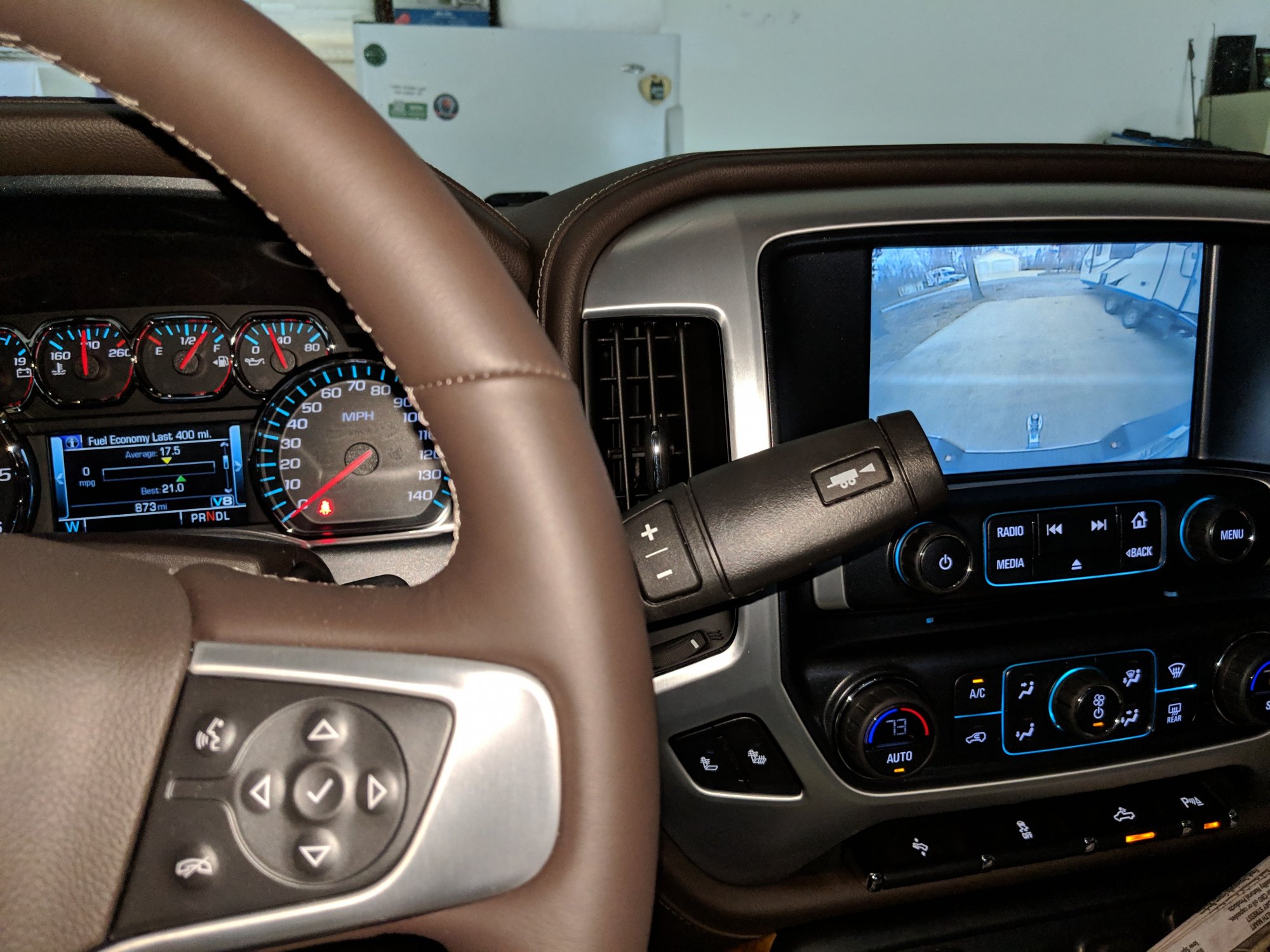

Something I just noticed today, is while in motion if you put the drive selector in neutral and turn on the cargo light my backup camera comes on. It will also do it with the drive selector in Park, and the engine running.

Hmm.  Will have to try this.  Could Grjfef have wired something wrong?
