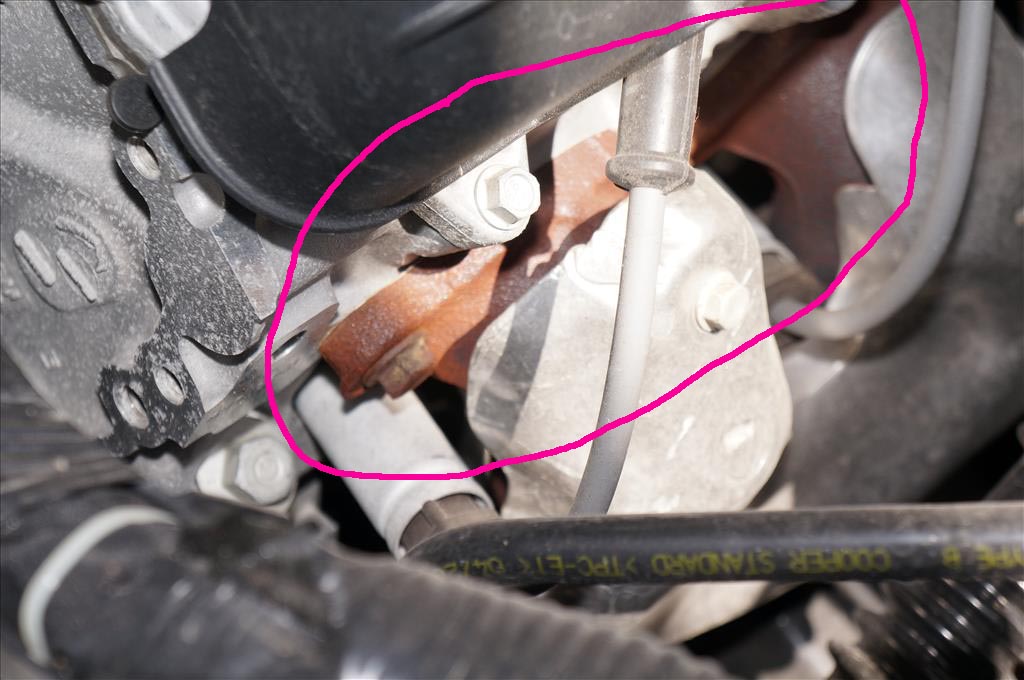

Is this rust normal for a new truck 2014 under the hood? I do have also frame rust pictures in another post.

From GM:
Some customers may comment that one or more of their vehicle's underbody components are showing some form of corrosion.
This corrosion may be red in appearance (rust) if the component is steel, forged iron or cast iron.
This corrosion may also be grey or white in color if the component is constructed of an aluminum alloy.
Note: Extended outside storage may increase the opportunity for brake rotor rust. Vehicle braking systems tend to be self-cleaning while vehicles are in use, preventing any build-up of corrosion on the brake rotor surfaces. At times more extensive corrosion can cause pulsation due to thickness variation. This usually happens when the vehicle is parked for long periods of time in humid type conditions and the braking surface area under the pads corrode at a different rate compared to the rest of the braking surface area. Cleaning up of braking surfaces (burnishing) can be accomplished by 10-15 moderate stops from 56-64♦km/h (35-40♦mph) with cooling time between stops. If multiple, moderate braking stops do not correct this condition, refer to the latest version of Corporate Bulletin Number 00-05-22-002 - Disc Brake Warranty Service and Procedures for additional information.
General Motors uses a large variety of materials in the manufacture of vehicles. Many of these components undergo an extensive corrosion protection process. These components include major body structures, powertrain, wiring and electrical components and various other areas of the vehicle. General Motors engineering determines the effects of corrosion on every vehicle component.
Acceptable Corrosion
General Motors has determined that the performance of some components is not affected by surface corrosion and no longer takes preventative steps on these parts.
Rust
This corrosion may be red or brown in appearance if the component is made of steel, forged iron or cast iron.
These are typical underbody or mechanical components such as but not limited to propshafts, propshaft yokes, U-joint, steering knuckles, brake rotors and calipers, axle housings, springs, shock absorbers, suspension control arms, tie rod ends and exhaust system components. As the rust ages, it turns from an orange-red like appearance to a darker brown like appearance.
Aluminum Oxidation
Cast aluminum alloy components may appear to have a grey or white coating on the surface commonly known as “surface oxidation.” Uncoated aluminum alloys begin to oxidize as soon as it is exposed to the atmosphere. This coating does not affect the serviceability or performance of the component.
Many mechanical components are cast in aluminum alloys, these components may include, but are not limited to oil pans, valve covers, transmission and transfer case housings, steering gears and axle housings.
Yes it is considered normal. The frame deal can be fixed under warranty.
Have you never looked under a hood before? Absolutely normal.
It's a CAST IRON EXHAUST MANIFOLD! Every single one, ever made in the history of the world, made anywhere in the world, looks just like that. Stop spouting your China nonsense.

Just be glad the block isn't cast anymore. You know how many engines I stripped down and painted right in the engine bay just to cover up the rust over the years ha ha.
At least today they do make high heat products you can spray on the manifolds.

The blocks are still cast, but out of aluminum, not cast iron. Hence no rust.
