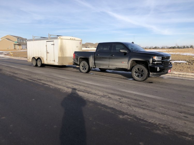

 Here's a better front shot with a decent load in the trailer (16.5' steel chassis tandem axle) there are 2 snowmobiles in the trailer at the time.
yes, tandem axle aluminum. pulls nice and has good tongue weight.
Wow.. hauling my 16’ enclosed on all stock suspension no leveling or drop I already sag.. I want to go to 5100s and level but would definitely need air bags. With the factory rake and my trailer hooked up I’m already a little lower in the back.
