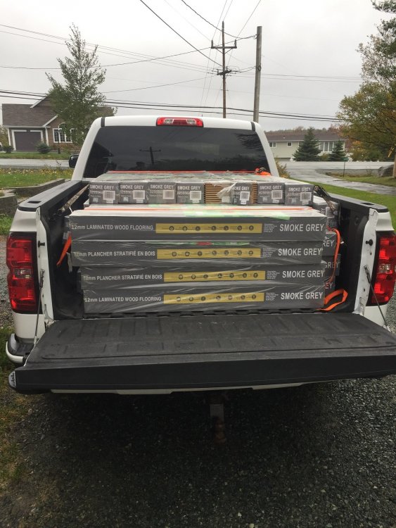

On ‎12‎/‎28‎/‎2017 at 9:13 PM, ESSGUY said:
Have a 15 ecsb ltz 4x4 with 6.2 and leer cap, have 2"rake now,36.5 front and 38.5 rear, want to leave 1-1/4-1 1/2"rake for tow/hauling. Thoughts on bilstein 5100 set at top and a 1" block in back or 3rd setting an no block in back, stay with 275/55-20 tire. Worried at top height I'd only have 3/4-1inch rake and would be nose high with 2-300lbs in bed?
I have a 1" block in the rear with 5100s in both the front and rear, set at the hghest setting in the front. There is no ass dragging with 2-300 lbs. I'll try to get a pick of around 2000lb in the bed to show you that it is not drastic...
Yes, I know - well above payload.
Edited by tanner709
thanks for the reply, i think i will set bilsteins at 3/4 in front, truck is not a daily driver and when it is used it will be either loaded with hunting equipment and dogs or towing 4 atv's.
