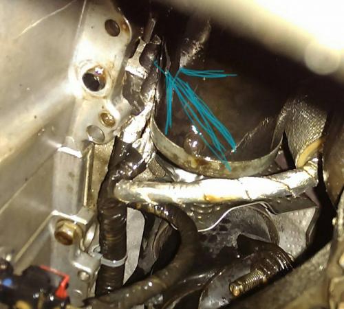

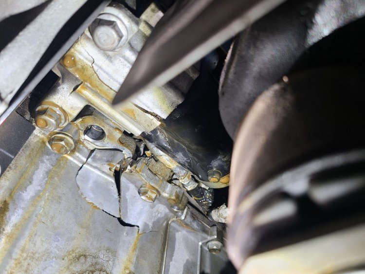

The regional rep was either new or a total D-bag. Probably saw my truck with all the accessories and such and then saw the K&N and thought.. I bet this guy tuned his motor, im going to get a big atta boy from GM and save them 10,000 bucks.
The dealership acted as if afraid of him for the most part, they pushed but not as hard as I would have. Why it took them 3 weeks to decide to dump the computer and pull the valve cover is beyond me. Insanity
Only thing I can surmise is that since this is one of the first engines to implode like this on the new 6.2, and with how bad it really was, "passenger side hole was as big as a softball minimum. almost volleyball."
I think they wanted to cover all bases, but it could have been handled MUCH better by all accounts. First dont attack me like I blew it up on purpose, or changed your factory settings, dont put me in a freaking toyota camry and tell me its not your concern I am in that vs a gm product or truck at that matter, dont tell me the CAI caused the engine to do that when a mechanic in the world couldnt back that claim...
Just bad all the way around. And of course some miscommunication mixed in as well.
K&N was fantastic, kept me mostly sane about it. Now its just the clean up and being made whole part by GM. Hell a freaking apology would go a mile in this case for me. Parts fail, it happens. But they could have handled it so much better. Just shows were all minnows in their ocean.
