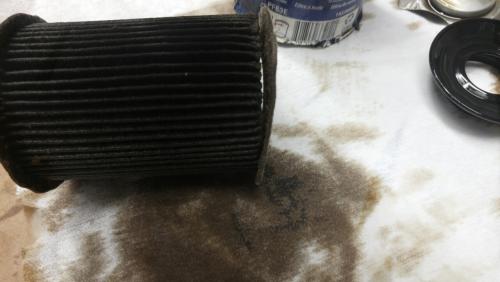

I changed my oil this past weekend. The truck had about 5k miles on the oil and filter -- a bit early but I like to get it done before it starts to snow and like fresh oil during the winter months.
Anyways I decided to open the filter up so see what these new E-core filters looked like. I wasn't impressed with what I found. I'm sticking with Wix now that I'm done with the free dealer oil changes.

For those that don't see what's wrong with the AC Delco filter, the end cap on the right was peeling off before I pulled it out of the can. The filter media is thermally bonded. Not much of a bond IMO.
I've run M1 filters for around 40,000 miles, about 30,000 of that with oil analysis. No issues yet. But I wouldn't hesitate to use Wix or Bosch.
It's almost impossible to know. The spring probably held the end shut for tthe most part but I'm not interested in rolling the dice on the e-core's. That opening also looks like a nice bypass for junk to go through and ruin the engine.
