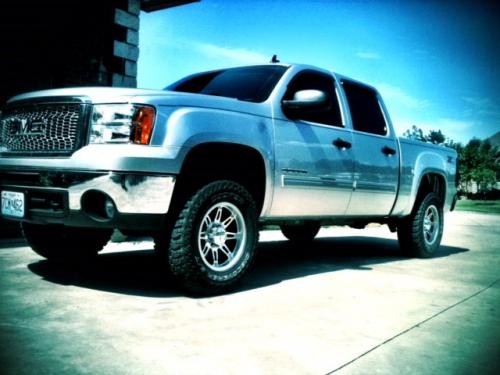

On my 2011 GMC Sierra CCSB I put the 3.5 inch RC with new UCA's, shocks, and all.. and after 5,000 miles one ball joint went bad. Replaced with MOOG then at 30,000 miles the other went bad. Replaced with MOOG and traded truck in at 36,000 miles. (I purchased the truck new and put lift on with about 750 miles on the truck.) It did look pretty sweet though, kinda miss the truck so I'm going to throw in a pic!
