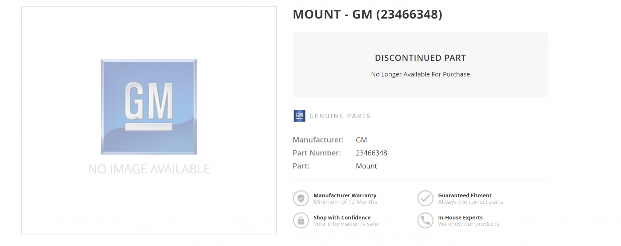

I have the 2014 GMC Sierra SLT 5.3l
Since 1 year the dealer are diagnosing the issue as a carbon build up on the throttle body and they cleaned and calibrated, although there are no error lights or DTC's. Afterwards I have done several visits to the dealer's quick service to do the same task. But every attempt ends with the same frustration, same engine vibration and rough idle.
But yesterday I decided to change the engine mounts (all) following a technician advice at the dealer but I had to go back to the dealer with the same vibration, later I was informed by another technician that there was a bullet-in about that on June 2017 and the engine mounts that I bought (01 Nov 2017) and installed have discontinued part number (23466348, 84086738) since August 2017 and the new ones (84175580, 84175581) which are not available.
