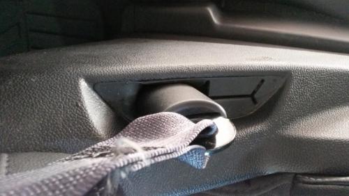

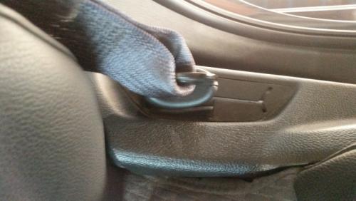

Well, I had the set belt recall done a couple of days ago before I saw this thread. Because I hadn't noticed anything screwed up when I looked at it afterwards I went out to the truck for a closer inspection.
Guess I was one of the lucky ones because my dealer didn't cut anything to fit the new bracket in place. What they did was, in the existing slits, bend the outside flap down against the bracket so it can no longer be seen and bent the inside flap up along side the bracket on the inside. It' fits snugly but no cuts. It looks fine to me, although if I knew ahead of time that my dealer was going to cut the hole for the bracket and butcher the truck like some of the pictures posted I probably wouldn't have had it done. So, if you're in doubt about getting this done you might want to check with your dealer to see how they actually do it. Doesn't look to me that my dealer made any changes to the bracket hole at all and it seems fine.
I took a couple of pictures of the install but couldn't remember how to post them so if someone can guide me through the process I'll try again.
Thanks to Big Thunder maybe this will work...........No cuts!
