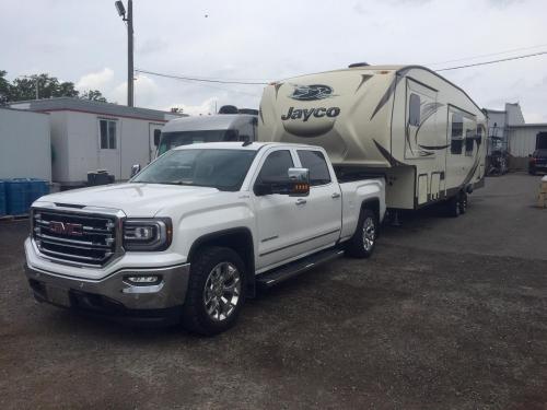

I figured out how to post a pic with the help from Krusty, the truck handles it great barely squats it down at all.

I have a similar truck and curios about the 5th wheel ride. I pull a 32' travel trailer and bounces like hell on bridges and gears way down on hills. How does the 5th wheel pull?

What's the pin weight? Barely squats??! C'mon

Looks like it sits level like that. Wish my truck looked like that without load instead jacked up 3in in the rear.

My pin weight is 1500# yes I'm over a little on cargo weight but good an all other numbers., it handles it ALOT better than my travel trailer which was lighter.
The only complaint I have is the shocks are not the best, I get a lot of bouncing on rough roads.
We just did a trip to the smokie mountains and it did great thought the mountains.
