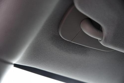

Well. mine has started leaking too. Right out of the driver side visor mount. Wiggled the sharkfin and tons of water came flowing out from inside of the sharkfin down the roof of the truck. Mine's going in for warranty service this week for sure.
Note the gap in the gasket on the back side of the sharkfin and the water on the headliner at the visor base.
8 months old. Frustrating.
They all have that gap in the gasket at the back. I don't know why but they do.

So would it be worthwhile to seal up that gap in the seal? Preventative maintenance?
In the 6 trucks I have had since 2003 only the 2014 ever leaked. That is when I noticed the gap at the back as I was checking antenna for cracks or something. I looked at new trucks on the lot and they all had it. I am not sure why the gap is there in the rubber but I had to pay to have a new antenna installed ( off warranty) I believe it was about $400 or so. If I ever have another one leak off warranty I will spend $7.00 on a tube of silicone and run a bead around it instead. Maybe one of the GM mechanics that are on here could enlighten us as to why the gap is there? Maybe it is for thermal expansion or something.

It makes no sense to have that gap there. It's a perfect spot for water intrusion. They need to just use a one piece continuous gasket. A split gasket like this is completely unnecessary in an application like this.
It sure seems it would be.
But now that there is water in my headliner, it's going in to service dept for warranty work.
