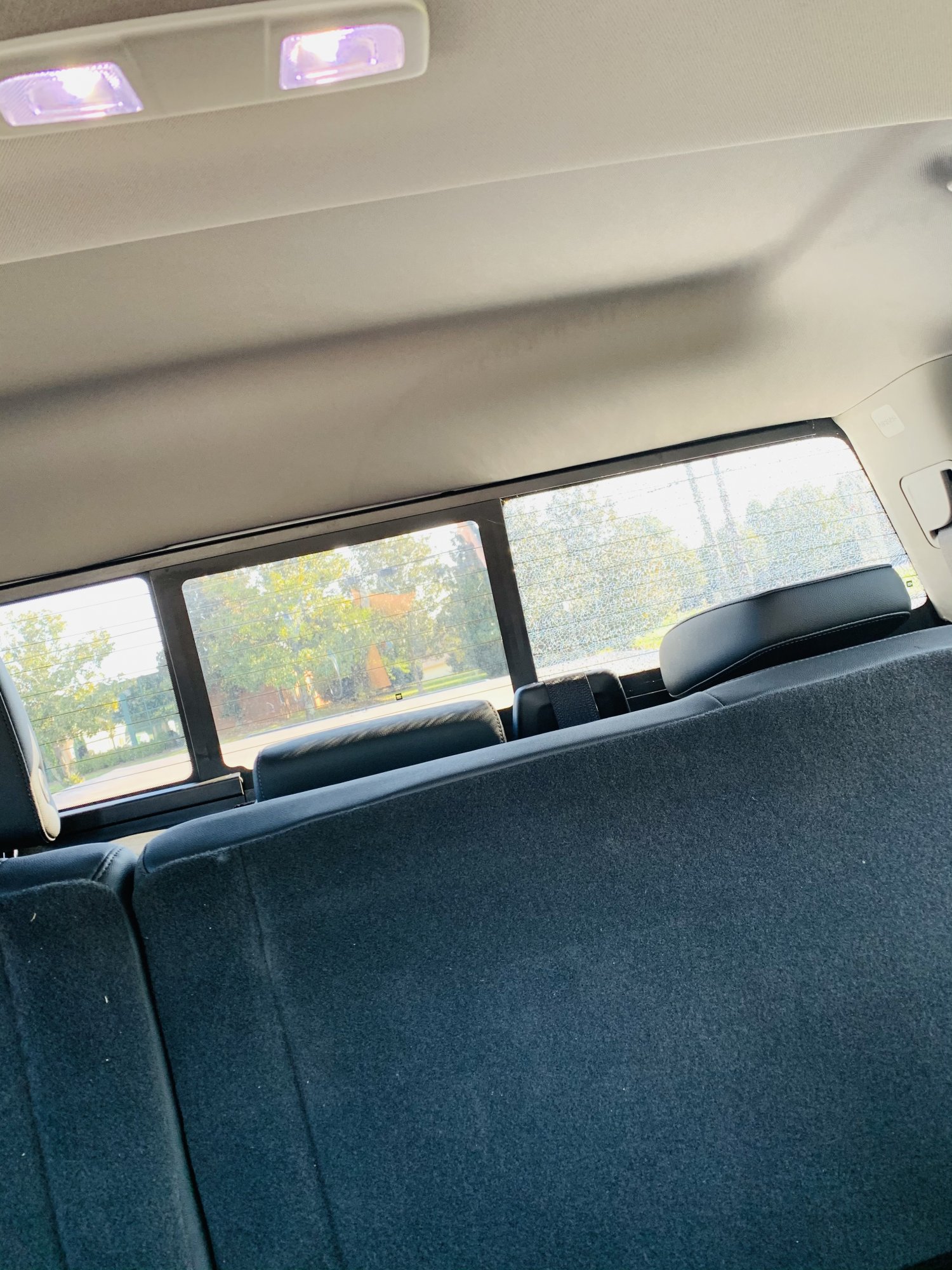

Hi eveeveryone, it happened with my chevrolet silverado trail boss 2019. So long story to short
i live in SC at this morning about 50 degree. Normally i drive my ford suv and the truck i just parked at the driveway but thay dat i have to pick up some lumber and i saw my truck from my room and i did get remote start to make the engine getting warm because i saw front windshield and back very foggy. And after 5 minutes i getting to my car and put defogger for both after i drive out of my driveway I hear loud  sound like the gun shot. I thought that is bullet travel but aftet look all my car i did see any body damdamage but the back window broken. Still don’t know what is reason but my truck still have warranty hope they find a reason to have a recall for safety for you and everyone
i did drive to dealer and told them what is happening and show one people had the same situation like that.
just let everyone know just be careful maybe they will have a recall in the future

Sorry to hear about your problems with rear window.  I thought the 2019’s and newer models weren’t affected by this problem?  I had the recall done last November on my 2018 Sierra Denali Ultimate 1500.  They inspected the contacts on the heater element underneath the black plastic cover under the rear slider and there were no signs of corrosion or melted wires .  No further action was taken.
Hope they sort it out for ya....
