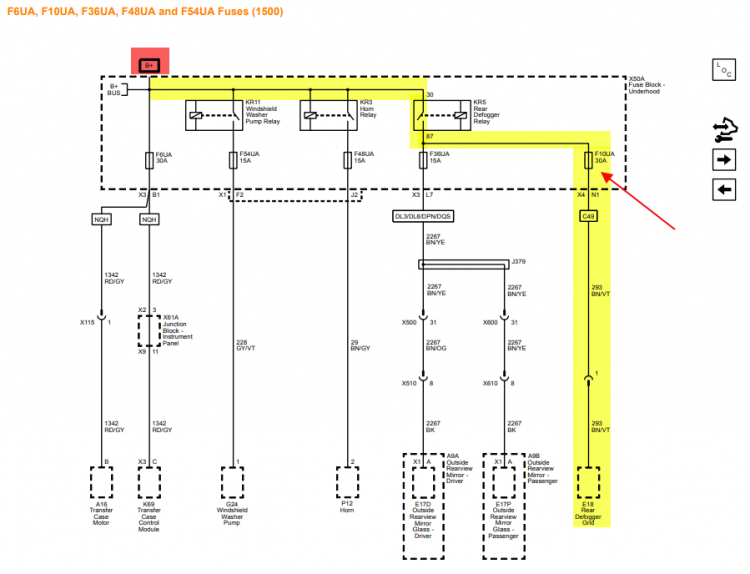

I am sure there are other ways to fix it and I think that most here on this thread would be happy to spend $20 fixing the problem. I don't need or want to sit around and wait for GM to maybe do something 5 years from now. Problem is, no one but you apparently knows the answer...There is a lot of brainstorming in these 16 pages and no one has come up with the solution. The only other thing drawing current is the sliding window itself. That would mean a stuck "window close" relay that it constantly running B+ to the window. We have all reached the conclusion that it is the defogger because it has only happened when that circuit is closed and sending current. In the first hand accounts, a burning smell and smoke is seen at the point in the glass where the sliding window makes contact with the fixed side. The schematic shows that the only thing controlled by the underhood fuse #10 is the rear defogger. Am I missing something here that others can surmise?
