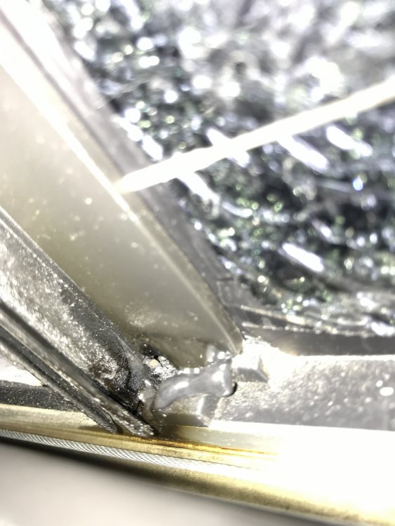

Hello All, I’ve lurked on the board for quite a while and learned a lot and done many of the suggestions/projects. I finally registered when I had this problem earlier this week. I had my rear defroster on and was sitting in a drive-thru (i.e. I know it wasn’t a flying rock) when I started to smell something burning. I thought it was the car in front of me and didn’t think much of it. I then heard a loud bang from behind my head and looked back and saw smoke from the right side of the slider and my driver’s window was shattered. I found the burn pattern consistent with others.
I read the forums, taped it up, disconnected defog fuses, filed a complaint with the NHTSA. I tried to get the area service representatives contact info, but was told by multiple people that he only deals with the service department and not customers directly. I contacted the commercial unit manager that sold me my truck and he confirmed, but told me to take it to the service dept and he’d have them give it a look. They told me it’s out of warranty, so I asked for a referral to the area service rep. They allegedly pushed it up and told me he said Chevy would contribute 0%. I said that doesn’t sound like anything and he said they won’t pay for anything. He told me to open a claim with GM and have the window replaced for about $750 and then give them a blank check to troubleshoot the defroster issue that caused the fire. Then he told me there’s only one window unit in all of North America and it’s currently located in Canada, so it would be at least six days for the dealer to get it and then I’d have to schedule the repairs.
This sounds like a bunch of bull. Has anyone else had more success with this? And is the overheating issue that’s causing these windows to shatter located in the window unit or is it elsewhere in the truck (i.e. am I fixing the problem by replacing it, or is it possible to happen again)?

Just an update on my window that shattered:
I had my window replaced through insurance at the dealer the next day because the glass began to fall out.  I contacted GM and they opened an investigation on my complaint.  I sent them pictures and was surprised they kept in contact with me every other day.  They told me to have the insurance company hold off on paying the repair bill while their engineers reviewed.  After about a week and half going back and forth they admitted that there is a known issue but would not cover the cost and to go ahead with the insurance payment.
I have taken the fuse for the rear defrost out so this doesn't happen again...
Fuse isn't the issue or the solution. More so for other people that that circuit covers. But your truck do as you wish.
