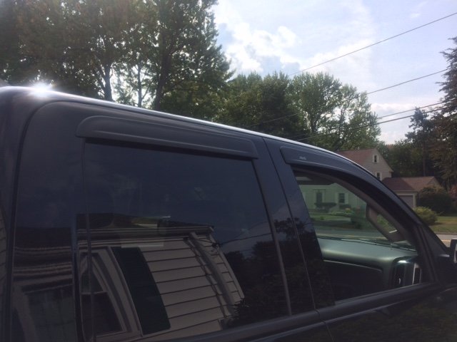

I bought the 'stick on' AVS low profile ones this time around. I love the flat look, but they're not quite as functional as my old in channel bubble type ones were. Window needs to be up a bit higher to prevent rain from dripping in. No big deal.
I like the look of these :thumbs:
